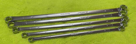

Bumping this thread.... I have newly acquired set of Wurth double box, and unlike many of the above, they don't have 'duplicate' sizes on different wrenches, but a true no-skip, one of each size only set... i really don't know if these are made by Wurth directly or a OEM branded tawainese wrench, any others out there that are similar or nearly identical?
wurth wrenches - 1 (2).jpegwurth wrenches - 4 (1).jpegwurth wrenches - 3 (1).jpegwurth wrenches - 2 (1).jpeg

The Wurth's were actually a really good deal as well... Though you have to order them as individual wrenches rather than a set. $60 and free shipping...
