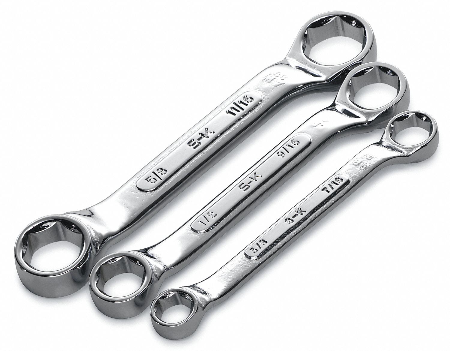

Off topic, but does anyone even make a double box end that is not 12 point?
I ordered some at Grainger's clearance sale a couple of days ago, but I haven't taken delivery yet. $25 for the set.
http://www.grainger.com/product/SK-PROFESSIONAL-TOOLS-Box-End-Wrench-Set-21A272?s_pp=false
Sorry for the oversized pic -- it's a web link photo and I can't change the size.
21A272_AS01
