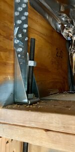

It’s an engineered structure but this detail is not specified. I’ve got 36ā€-7/8ā€ Simpson SSTB anchor bolts embedded in the foundation with hdu’s to anchor posts at various points.
I’m using coupling nuts and where needed shackle and cable/chain to tie the rafters down to the anchor bolts with additional hdu’s. . I got ā€œgoodā€ 5/8ā€ threaded from American bolt company. From memory, I think it was a193-b7.
All in an effort to secure the roof against extraordinary winds. I just don’t have faith in the specified (tiny) Simpson rafter ties in the spf top plate. [edit-the h2.5]

Have you seen those full-scale model lateral tests they have on their website (Simpson Strong-Tie)?
I want to say the controlling failure mechanism appears to be the wood fibers crushing, hardware deforming and/or hardware fasteners deforming. I don't recall ever seeing the actual threaded rod fails. I'm thinking of the holdowns at the shearwall ends.
Can you post of photos of what you are doing? What was the structure designed for as far as wind? You can PM if you'd like.

I’d have to go check the plan notes regarding wind. The PE and I did not specifically discuss it. He was pretty well seasoned and I’m sure it is appropriate for the area.
A couple of samples below. Simply connecting the rafters to lower down on the structure. This particular one runs down to a point above a door. Otherwise to the foundation. This spans a joint in the exterior 3/4ā€ ply.
I will remove the double nuts.
Edit-and I’ll look for the lateral tests. Thanks
Why remove them?

As far as I can tell, they add no strength to the overall system. I’ll locktite and or spray the exposed threads with rustoleum to keep them from creeping back.
