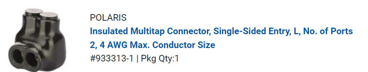

I installed a 125 amp breaker in my main panel to run a sub panel in the very bottom position. There was no restrictions on where this breaker could be, BUT when we had solar installed, there was a requirement that solar/backfeed breaker had to be installed in the bottom of the panel. (Opposite of the load). So they had to move this 125 amp breaker up, the cables were too short and they used a connector like the one in the photo. (and it did take up a lot of room, no much space left in the main panel to do anything)
