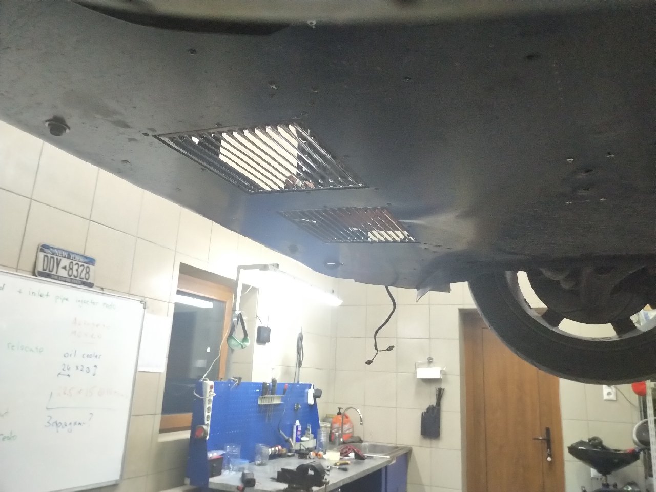

Either I dreamed them into live, or they exist
I believe I've seen some special sleeves that when squeezed created washers
I have a DIY undertray made out of composite aluminium, and I want to add those double sided washers where the bolts holes are - this way when torqued, the undertray material doesn't get too squashed
Is there any DIY or designated products for this?

You could also cut some Aluminum or stainless fuel line to the correct length for the thickness of the undertray, you would now have spacers inside the hole of the undertray. In effect you would be tightening the washer to spacer and not crush you undertray.

In plastic and other composites "compression limiters" are used to allow for proper fastener torque without yielding the base material. I have not seen a DIY version, but all you need is a spacer and couple of standard washers. Or a insert washer and a standard washer, this version is easier to assemble.

You can make the crush-limiters/compression-limiters on the lathe.
Its just a "top hat" with a clearance hole for the fastener. Choose length of the "top" to just trap the material, I'd say no more than .005-.010" interference. Can also add a thickness of something like HDPE or other elastomer to prevent rattles in the stackup. The softest material is going to get squashed the most.

Something like this get you started?
