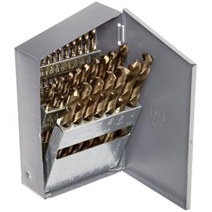

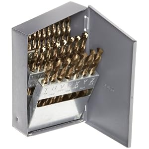

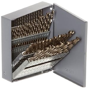

You will never regret spending the money on something of quality. A set of cobalt bits from Chicago Latrobe will set you back over $100, but at least you want be kicking yourself for not buying a better set the first time.
http://www.amazon.com/gp/product/B000LDIR5Q/?tag=atomicindus08-20
http://www.amazon.com/dp/B000LE895S/?tag=atomicindus08-20
http://www.amazon.com/dp/B004IPPGYI/?tag=atomicindus08-20
