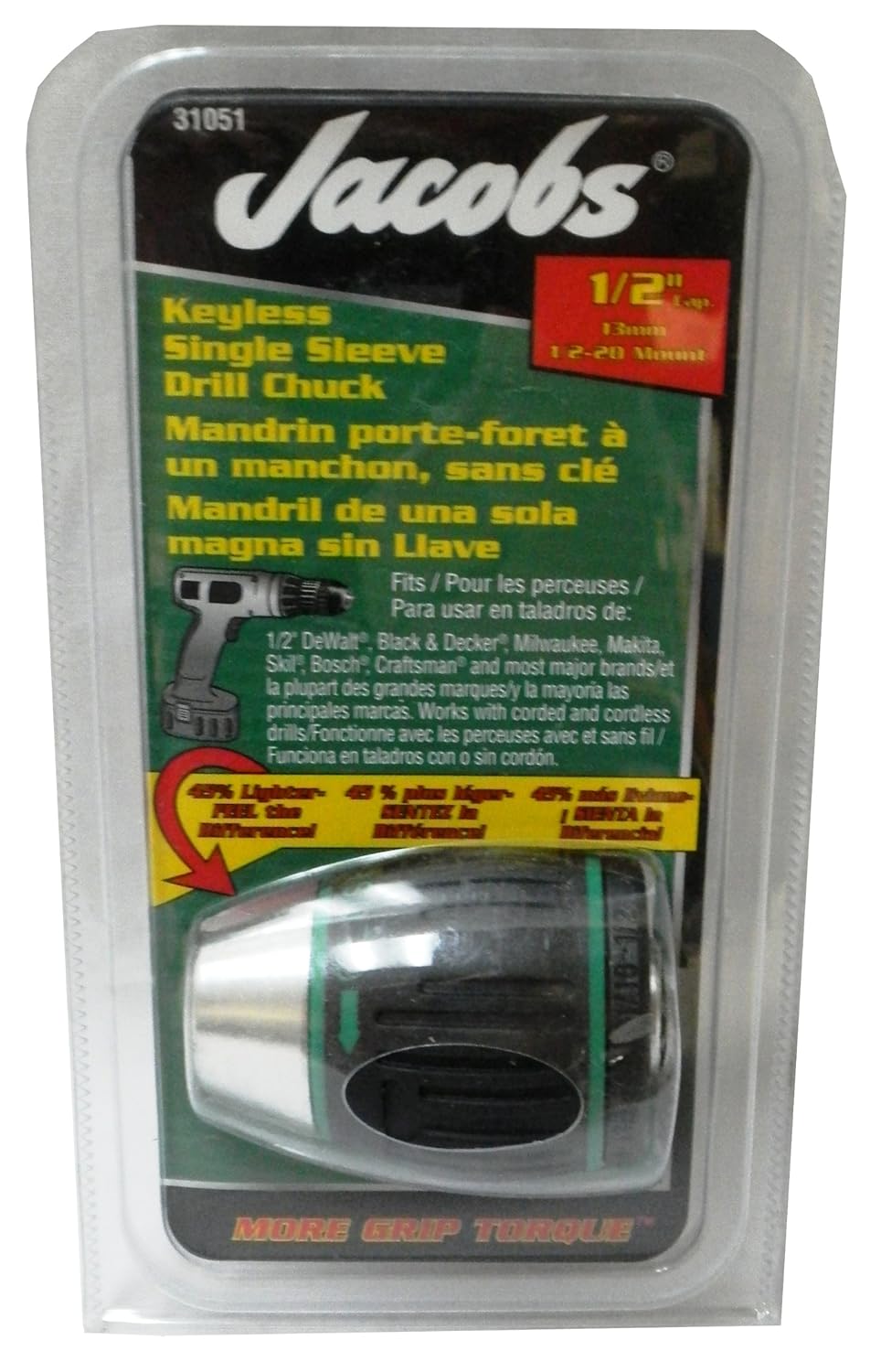

Are steel keyless chucks as strong and durable on a 1/2" as a keyed chuck?
Silly question!! Not all chucks are created equal.
FAIL:

As Dave suggested, the cheap keyless chucks have very little holding power.
