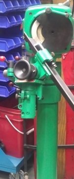

Sterling have been making this basic design drill grinder for about 100 years. If you want to have one of these exceptional grinders, you will have to call and leave a deposit then wait almost a year. The demand is there with tradesmen.
FYI, the price is around $4k usd.
I looked for a year before I found a used Sterling. I paid $500 usd.
I called and ordered a few replacement parts. The customer service was really good, and I had the parts in hand in three days. The customer service person was kind enough to give me a build date when I gave her the serial number on my grinder.
The Lisle 91000 in not in production. Lisle have parts. The 91000 shows up on Craigslist about once a year. The used price is about $200+. A really pristine one can be twice that $200 asking price.
The Sterling was always three times as expensive as the Lisle.
