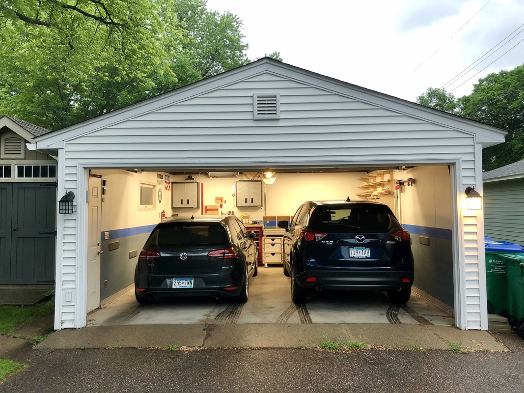

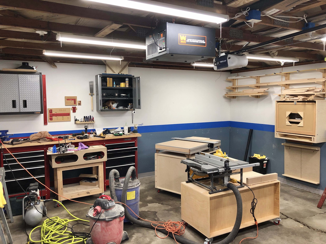

Hello everyone,
I'm looking to add a drill press to my small 18x20 garage that I also park my cars in. It's got to be small-ish, benchtop model. Not looking to spend a fortune but don't want junk, either.
I predominantly do woodworking projects, and have had multiple times where I've really wished I had a drill press! But I don't think I need huge capacity, or have the room for that.
My question is, I was looking at something like this baby Grizzly G0925, which would definitely fit in my space. And seems decently reviewed for its size, plus good price point.
But then an option (I'm sure there will always be more) like this 12" Grizzly G1199 showed up on fb marketplace for $200. Older model, about twice the price of the "baby" 8 inch:
My question is, given my shop size constraints and probably somewhat limited use, do you think it is worth it to get a larger model and make it work? Will I regret getting a small one? I've never had one before so it's hard to forsee every single thing I might use it for... also, is this used 12" Grizzly for $200 a decent deal? They say it is mechanically in good shape.
Thanks for any advice, and here's a pic of my space so you can see what I'm working with. Have to keep everything on the back wall pretty much to get the cars in:
Thanks!

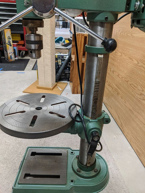

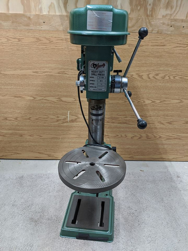

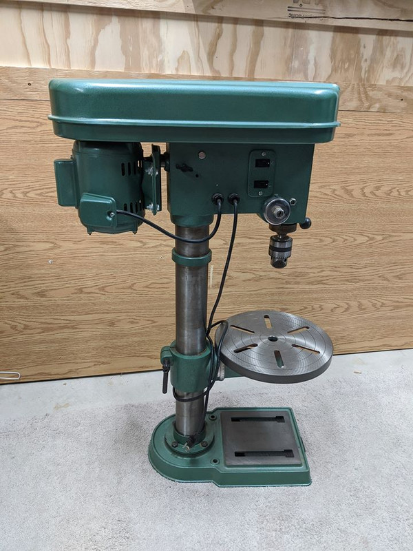

I have the Grizzly G1200 Drill press= the floor model of the one you reference.
Bought it 35+ years ago, it's been awesome. Still running original belts and motor, did replace the chuck a couple of years ago. COO was Taiwan, not China.
This thing has drilled tens of thousands of holes, will do 5/8" diameter in steel with a good sharp bit and a well-secured workpiece. It runs smooth, quiet, and has served me well for three and a half decades. Mine is a floor model, but I can't really remember a time when I needed the additional height.
Buy it.
