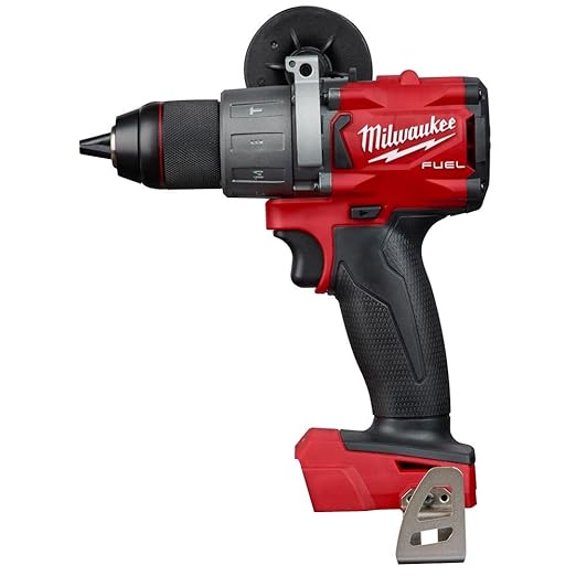

I have a Milwaukee D handle right angle drill that I use to drill studs. Wired a few houses, garages, and sheds with it. Plows through stacked 2x4's pretty easy with an auger bit. I can also use it as a straight D handle drill by removing the right angle attachment.
https://www.milwaukeetool.com/Products/Power-Tools/Drilling/Right-Angle-Drills/3002-1
I used a borrowed one of those years ago and would love to have one, I just don’t know how much I’d really use it. Maybe one of my kids will want to build a house and I’ll have an excuse to pick one up. I did order myself a Milwaukee 0299-20 yesterday though.
