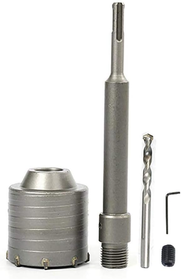

Do i need a hammer drill to drill through cinder block that is hollow and only 8 inches thick? I would do my best to drill through the hollow part to avoid the center brace with in block.
I want to make a hole 2-3 inches big. I have cordless drills, impact driver but nothing rated for cinder block. I did buy a SDS plus bit that is 2 inches.
I have looked at renting but i can buy a dewalt hammer drill or cheap harbor freight one for $40 more than renting it with a coupon but it is not a tool i would use a lot. I only need one hole. :)

For a 2 - 3 inch hole a core bit would yield the best results, you can rent one at home depot. We drill a lot of masonry, usually anything over an inch gets cored, less destructive.

Umm, you already BOUGHT a 2" dia SDS-Plus bit?
But don't have an SDS-Plus tool to put the bit into?
(2" dia solid SDS-Plus bit is a BIG one. A 2" dia 'core' type SDS-Plus bit is also not a little one. :lol:)
Bosch SDS-Plus core bit
https://www.boschtools.com/us/en/bo...peedcore-thin-wall-core-bits-t3914sc-33864-p/
Which uses a pilot bit that the core bit (cup) attaches to
https://www.boschtools.com/us/en/bo...ore-bit-extensions-and-pilot-t3926sc-35226-p/

I'd probably try this for $14. 65mm (2-1/2") https://www.amazon.com/dp/B06Y2CXDGS/?tag=atomicindus08-20
If you don't have an SDS not sure how well it would work though. Block is pretty soft and it might do the job.
Hell, I'm tempted to buy this just to have it. https://www.amazon.com/dp/B08JV77MVB/?tag=atomicindus08-20
That is actually the brand I bought. I do not have a sds plus tool will it not fit into a chuck?
Maybe I’ll just buy the cheap harbor freight one. Home depo wants $40 for a day rental.

2" is core drill territory and the thin section of a hollow block would drill very quickly. You can run that size hand held with a standard SDS and it will be fine, the drill wouldn't stand it if you were doing hundreds of holes though.

The block or the core drill? In my experience, these bits can work just fine on the web of the block. Drill an inch or so deep, break out the core with a suitable tool. Drill another inch, repeat. I've used these style of bits to drill through 12" of solid concrete. Proper SDS drill, a little water and some patience and you are rewarded with a uniform hole all the way through.
You DO NOT want to use a 2" diameter SDS bit to do this. Plenty of unrecoverable cap will happen in a cinder block wall. Use the core bit rated for SDS use.
