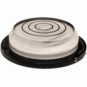

Put an old 1/2" bit or a short length of rod in the vise and level it so it it plumb upright.
Slip the drill motor down over it and snug up the chuck.
Mix up a spoonful of thick two-part epoxy and plop a glob of it on a convenient location on the back of the drill motor.
Get one of these and stick it down on the blob of epoxy, and set it until the bubble is centered:
Let the epoxy dry and viola! You have a vertical drilling aid.
You can find the bubble levels at most RV accessory stores.

Steve's got it - I need to find one of those because the vials on my portable have bit the dust.
