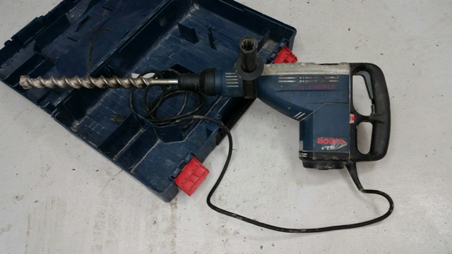

Just did this, but only one hole 1.5" wide and 8" deep...
Went quick and easy with this puppy I rented,

Sorry I missed this. Yep, we ended up renting a Bosch SDS Max from the rental house. They only had 1 bit in 1.5 inch and it is pretty dull and beat up.
