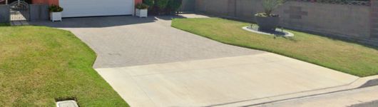

We get the occasional weed but, that's why God invented Round-Up.
Don't think we've ever redone the sand except when we've had to repair a small section that sunk due to monster rain. Maybe 3-4 times in 30 years.
We did the driveway, a courtyard in the front, and a patio (about 20'x20') in the back.
Not a great picture but you get the idea. All in a herringbone pattern.
