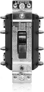

I have similar. And in that J box on the lift right near the motor I have a motor rated 2 pole disconnect switch. So I can kill power if the lift push button sticks etc.
Do you have a link to that switch? Seems like a really good idea. I had looked at disconnects, but they all seemed like the ones for A/C units in large boxes that I didn't really want to mount on my lift.
