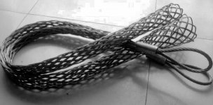

**** of Satan by Stanley Tool Works does have a nice ring to it. Maybe it should be a wire pulling tool instead of a trowel. Don't put your ***** in either.
