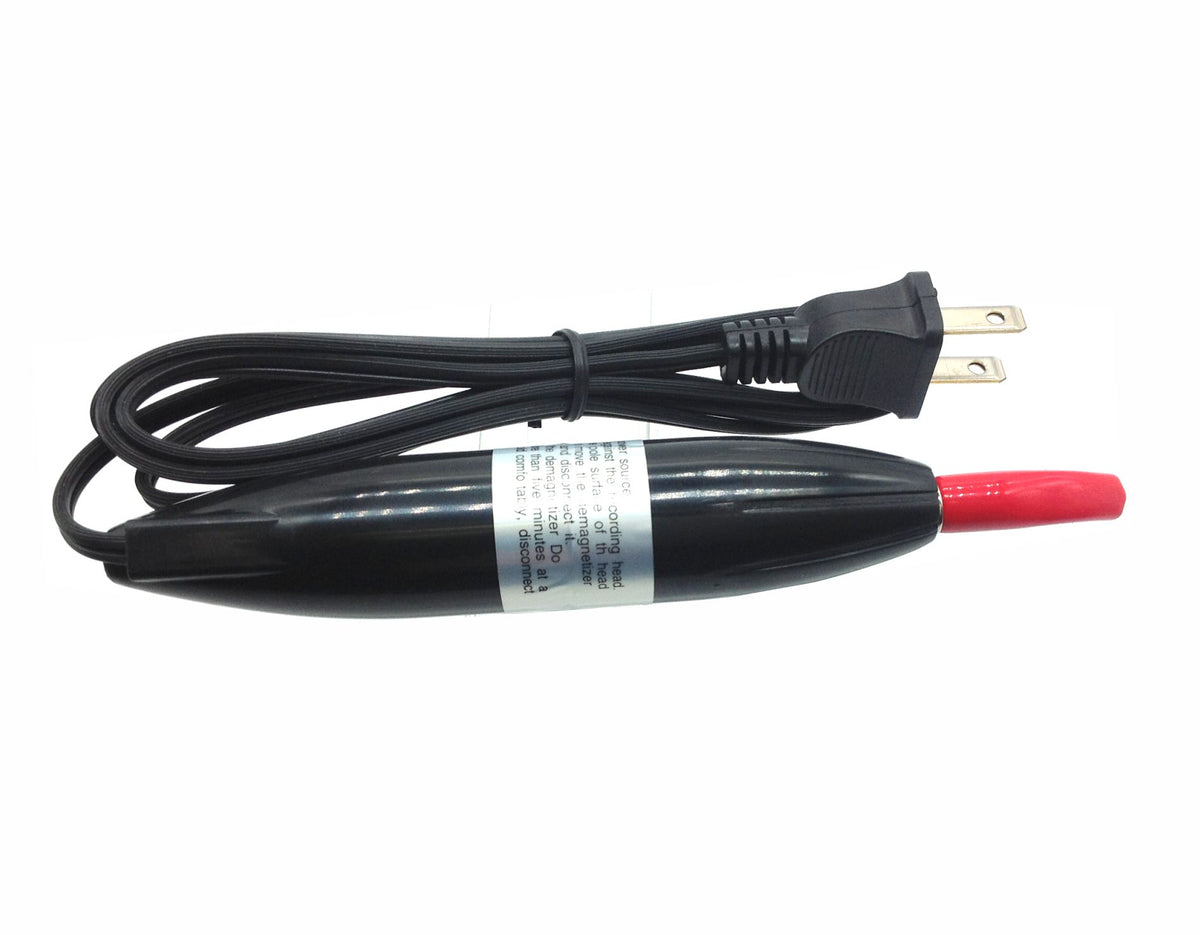

What about a stereo tape head demagnetizer where the field is concentrated at the tip.

Can you expand on demagnetizers? I have one for parts post surface grinding, I have not looked into the mechanism of how it works, I just assumed it was a AC electromagnet and by flipping at 60hZ it would demagnetize.
Something in that form factor would be the ticket. No clue if it would actually work but the price is not terrible if its a failure.

On demagnetizers: It *has* to be done with an oscillatory time-varying field that decays to zero (oscillating pulse). It *cannot* be done with a static magnetic field (you would have to calculate the exact field and orientation to bring into proximity -- this would be VERY difficult and need to be done for each screw). The time scale of the oscillation can be relatively fast (probably cycling over some 10s of milli-seconds with decaying amplitude would be fine). Something like that should have a button to trigger the pulse (I am not sure how the tape demagnetizer is supposed to work in that sense). That is why I suggested a watch demagnetizer and putting near the bore. You drive the ferromagnetic material around the hysteresis loop with decaying amplitude to zero so the residual magnetized amplitude will be zero. Something like this brought with bore proximity to the screw (lay flat on wall with open bore nearly centered on the screw and pulse) MIGHT work (I do not have one of these but it should, in principle, be able to work) without an R&D project to do it.
https://www.amazon.com/gp/product/B0058EDVFE/?tag=atomicindus08-20

...(I am not sure how the tape demagnetizer is supposed to work in that sense). That is why I suggested a watch demagnetizer and putting near the bore...
Both the tape and watch demagnetizers I'm familiar with use 60hz line voltage to scramble the magnetic domains in their magnetized targets. It works well enough if you start the steel part closest to the demagnetizer and slowly pull it away with the field on. It's not magic. Yes, a pulse might work better, but the thing about magnetized steel parts is that they're probably not strongly magnetized to begin with, so it shouldn't take too much energy to fix the problem.
Ah, thanks on the tape "demagnetizer" explanation. That makes sense if it is randomizing things on the tape. But keep in mind, that is likely randomization in the sense of not being spatially aligned domains to represent a signal (one way or another being 1 or 0 or perhaps an analog waveform with a range of values). That does NOT mean it is removing the local magnetization of the domains, just that you are scrambling them. That might be good enough to not have light, air-suspended metal shavings (metal grinding dust) stick to them. Maybe, maybe not. Randomization, if on very localized spatial domains of a magnetic material, would be enough for no net macroscopic magnetic field. In this system, I would presume the field is oscillating at the tip and relies on the person moving it around physically combined with the oscillation to result in enough randomization to wipe the media. But magnetic domains are oriented on the tape too. So it may be a different problem.
A decaying pulsed system would be more "pure demagnetization that should stand a better chance of working well.
