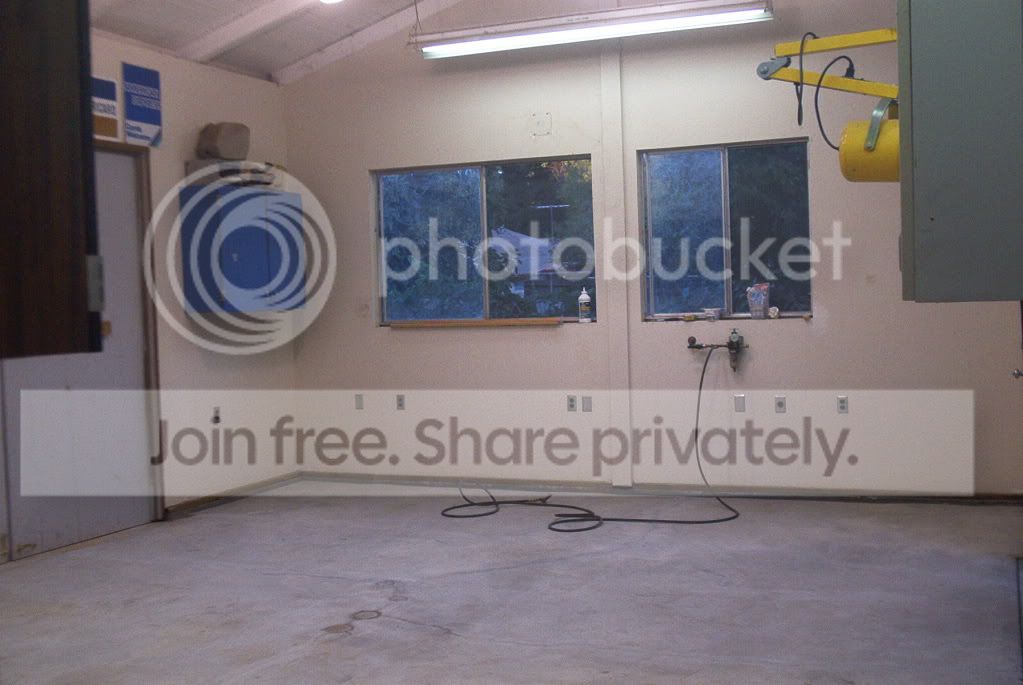

My shop walls are 5/8" drywall, taped, with a spray knockdown texture, back room that the shop is attached to was done with OSB when it was rebuilt. Prefer drywall but OSB was quicker but it stunk for a long while. The photos below show the contrast between the two, as OSB really is not a finish material.
Shop
Back room
