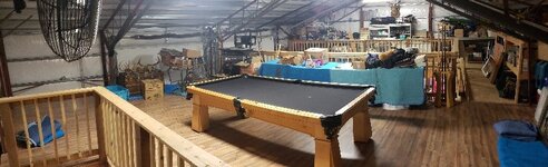

I have a 3ton AC furnace I've installed in my 30x40 shop. Right now I have ducts under the mezzanine which was just fine for winter but I've got to get the ducts up to the top blowing down since the mezzanine doesn't allow the air to get up top. What size duct would you recommend to get the air up top. I thought about putting a damper on the lower duct to shut it off for the summer and only needed for the winter. 8bec662debec85094609489578cb4729.jpg28bcad60fe0b6c59daafdda24e67e4bf.jpg0c09f4f0d01c129a06dc14aa738f16d6.jpg9a10d8d8a490526ff0c584e78ce3e8b3.jpg0ae0c06b0ca8e691912a8b25ad1da887.jpg26892d05eb1d148d9ac6741f9dca7e44.jpge6e9dd436fb1bf70649565c914c3751f.jpg

Right now there's a 8x14 duct that's 25 feet long under the mezzanine. It has six 10x6 registers on it. I thought this did good for the heat side of it but now after researching more and leaning how much output this system has I've realized I really don't know what I'm doing...lol. I've had just the furnace side of this system for two years. It's a Lennox 90 percent.

Pretty much the idea I had. Just debating on adding to the end of the mezzanine run and going up or just adding a damper on that and going straight up off of the plenum. Right now it's just open registers under there but I could replace them with ones that close if needed.

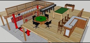

Thanks. I just want to be comfortable in there and entertain friends and family upstairs. The left side of the mezzanine is for my RC plane, model building and maybe reloading bench. Right side is my pool table, shuffleboard, card table and bar. Probably a drop screen. It's a mess but getting there slowly.

As far as the sizes I would go with 24x8 or 14" round up thru the floor and along the underside of the roof with one register @ 300 cfm in the bottom or side of that duct, and as far as going the 35' directions I would run 16x8 rectangular duct under the joist with 3 registers @ 300 cfm each.
you could change sizes after each register but it's not really necessary and it'll cost you more money.

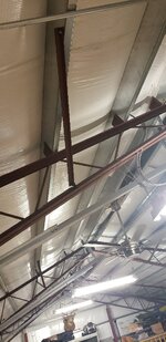

Up here measuring and thinking how nice it would be to just lay a panel over the battens and make them a duct but they're only 6x24 and it would get hot from the roof anyways. 7f4179ca01d3bd9204c9e17858701789.jpg6937d6da8baa9490e09b1abaf5c6c424.jpgb46711594d9bf5a90c2ebe2c00043590.jpge4668cd5d4edd56e4375071132eae552.jpg
The issue with that is you would have a lot of trouble making it airtight.
You could fir it out another 4 inches and make it 24x10 to meet your needs, but it wouldn’t be very airtight and probably very inefficient

here's another idea which might be a little more ductwork but maybe a better job.
it's a section view, with 10" running thru the roof joist the 35' way with two runs each having 3 10x6 registers @ 150 cfm each.
can you get a 10" round thru those roof joist?

yeah it's hard to tell from the pictures if there is enough room to get a 10" round thru those joist.
he needs to cut a 10" round piece out of some card board and see if there is actually room to run thru.
