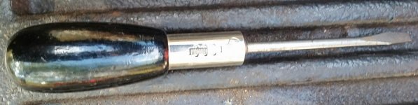

Stumbled across this screwdriver at the flea market today. Was surprised to see the condition, and even more surprised to see it was a Dunlap.
