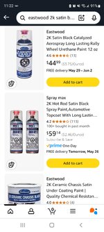

I would like to find some ~$20/can paint. Not sure if it's possible anymore.
I thought maybe there's some kind of industrial enamel in a can that is "real" and not big box store fingerpaint.
Spraymax 2k satin black is on amazon for $60 for a 2pack. Not $20, but better than $40.
