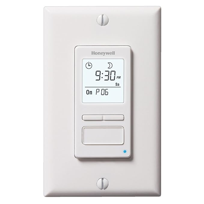

I got fancy today, and installed a couple of the HONEYWELL PROGRAMMABLE switch, to a new outdoor fixture, I bought for the backyard.
Super easy to install.
