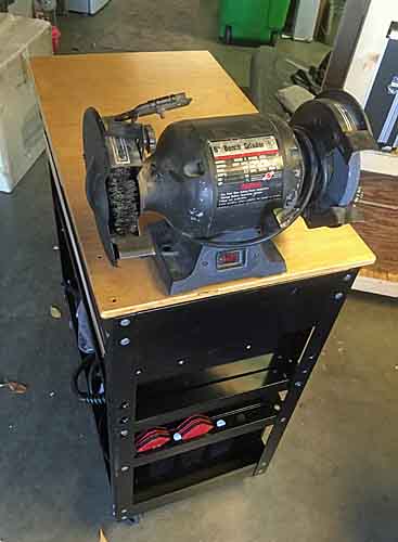

You could always just make a booth with a tarp. Constrain the mess to a small area. Me, I'm really worried about showering sparks in the same place as my woodworking mess. Too much combustible stuff around in my attached Suburban two-car slash 'workshop'.
Latest upgrade was a rolling tool cart / cabinet which I added a wood work top with threaded inserts so I could dog down my bench grinder and position the hole thing at the mouth of the garage, so the spark shower lands on the bare concrete driveway. Well away from the sawdusty corner where I turn money into sawdust and back into money again.
it's also serving as my crappy wire-feed welding cart
