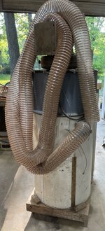

Just finished building a dust collector from items I had setting around. Works real good on my 12“ planer, 42” belt sander and Craftsman lathe. Still need to make an adapter for the table saw. Has a 20’ 4” hose. Very little carryover into the filter box. Not the prettiest collector but works well.E4C551FB-33E3-49DE-8F6C-CFC86841BC4C.jpegF67E5516-43BB-4974-A668-29272D9BCA2D.jpeg
