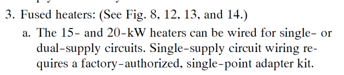

The heat pack unit is a Carrier KFCEH3001F15B. This is a 15KW 208/240 single phase fused unit. The installation manual is here https://literature.neuco.com/CRkfceH.pdf
It talks to the dual circuit feed method shown in Post 105's first picture. A single circuit feed is possible using a factory-authorized kit (which is not described and the OP acknowledged).
Below is Figure 8 which shows the dual circuit. Figure 12 is not relevant (24 and 30 KW 3-phase). Figure 13 is not relevant (24 and 30 KW single phase). Figure 14 is not relevant (24 and 30 KW single phase).
Table 3 provides the wiring information.
  • Circuit 1 is L1/L2, 40 amps, 58.5 min ampacity, 6 AWG min with 10 AWG min ground
  • Circuit 2 is L3/L4, 20 amps, 25.0 min ampacity, 10 AWG min with 10 AWG min ground
