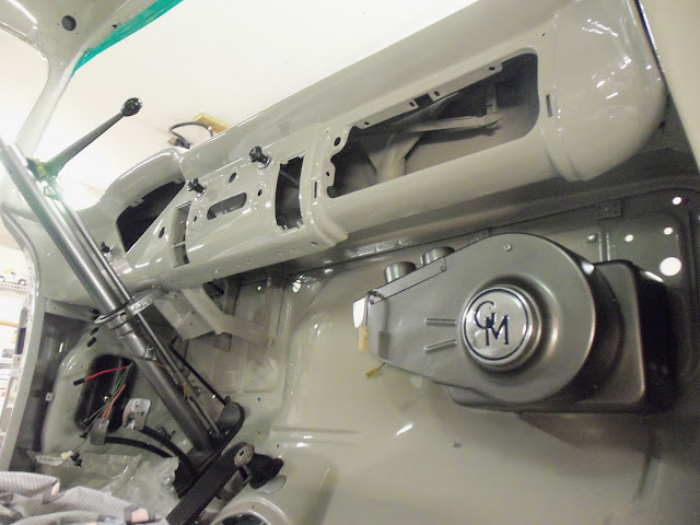

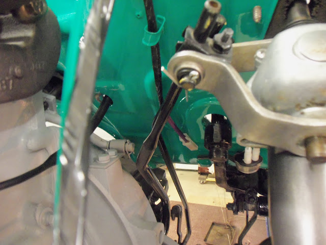

Also fit the restored heater unit and hooked up the gear linkages. With everything cleaned, buffed, adjusted and greased, things should work a lot better than they had for a looong time!
Did a little more on the steering wheel too. After letting the high build primer dry over night I'll sand it down with 220, then 600 wet, then put some paint on it - should look cool with new 2-tone on it.

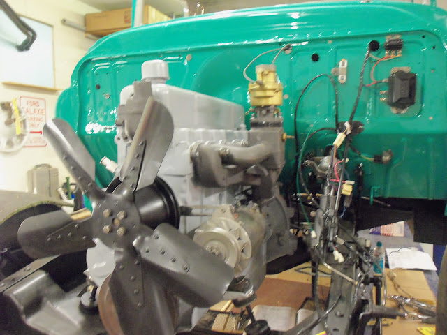

Looks like a 'belt & suspenders' approach to engine installation. lol
Man, your customers must be jazzed to see this quality restoration in progress!
Thanks for sharing (and teaching) all the particulars of the steps you are taking on this truck. :thumbup:

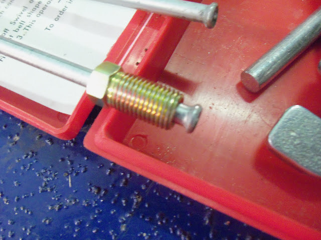

I like to use thread locker on critical fasteners. As it where, one of the wheel cylinder bolts was missing off this very wheel! Won't happen again though.

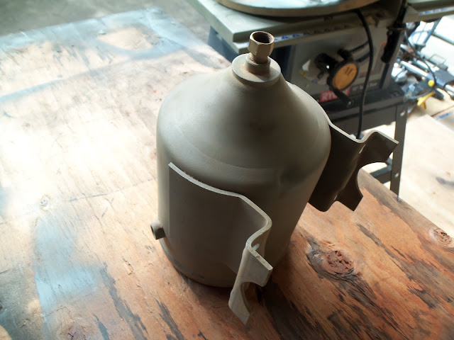

External Oil Filter:

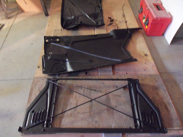

A few parts came back from paint today....
Some looking great -
Some looking even worse than they left....Guess I get to break out the guns!

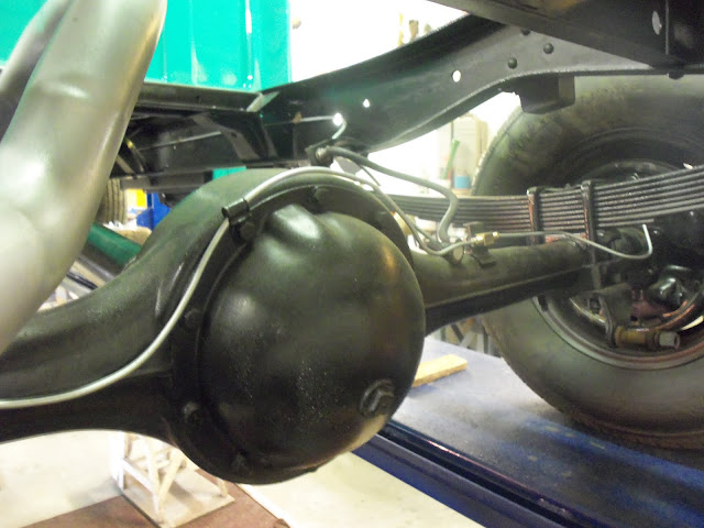

After figuring out that we got brake lines for a short-box, I bought line in bulk and will just make up my own. Although pre-bent is nice, making your own is more fun and you are garanteed a good fit!
Sometimes you can even get a little creative!

Made up all the brake lines:

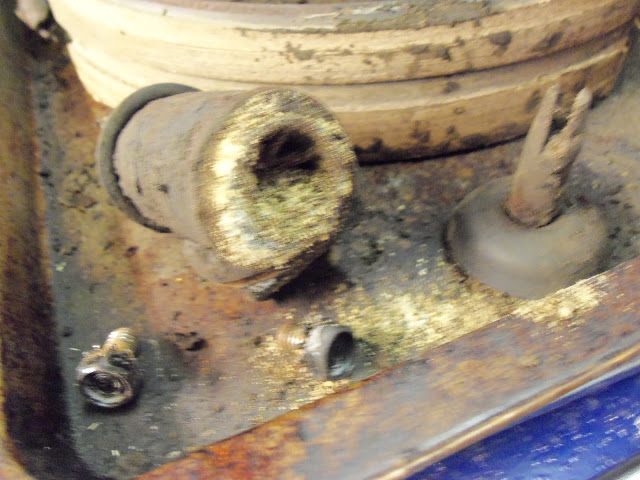

Earlier on, I snapped off two of the rear shock mounts, even though I had heated them red hot. I'm going to cut the heads off the bolts in the foreground, cut the old mounts off and drill through the brackets, then insert the new ones and weld them up from the back-side. That way the shocks will still mount up as the should.

but before that, I repaired the rear upper shock mounts:

Finsihed up the brake lines and bolted on the frame clips:

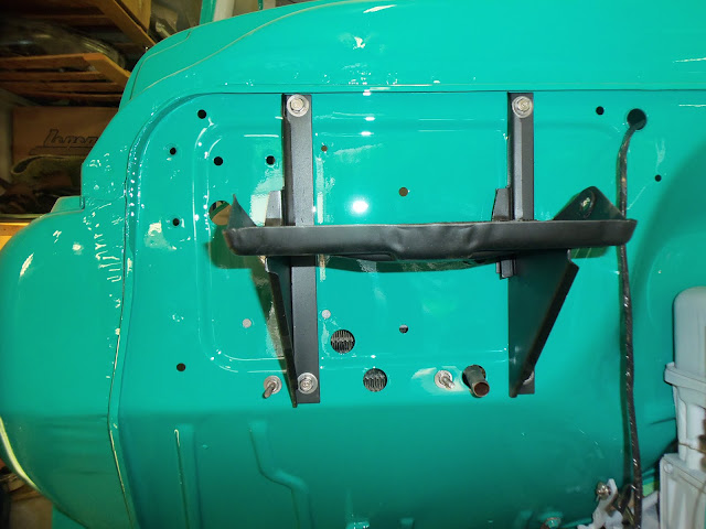

You may recall that a while back I made a door caddy to make door install and removal easier. While it worked well, I found it was a bit tight with big doors. So today I took it apart and re-engineered it (OK, I use that term loosely!). I removed the bars, cut and welded them into L-shapes to better accomodate larger doors like these:
and welded on an insert for the jack:
Now I can put the doors together with them standing upright!:thumbup:

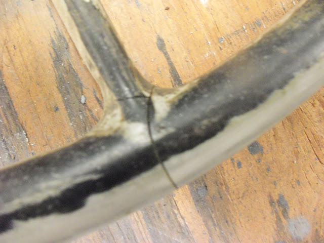

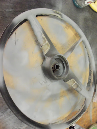

Almost forgot - sanded the steering wheel for about the 6th time and put a last coat of primer on it. Tomorrow I'll lay down color one of the 2-tone scheme:

Got the white on the steering wheel - tomorrow I'll mask it off for the black.

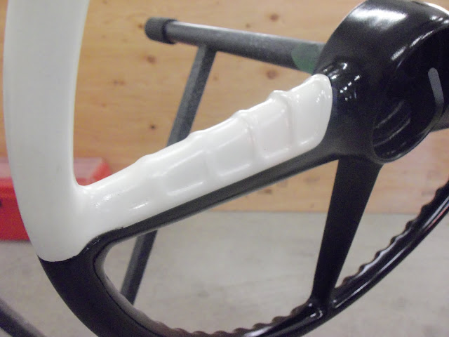

Steering wheel got all prettied up!
Let's review:
REPEAT X 6! :(:lol_hitti
