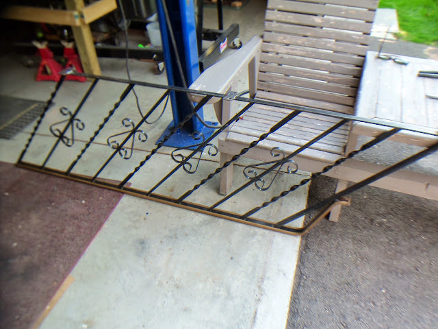

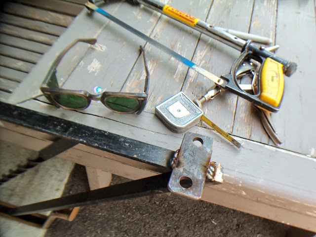

...meaning that my first task was to make and weld feet onto a railing, for one of our rental props...

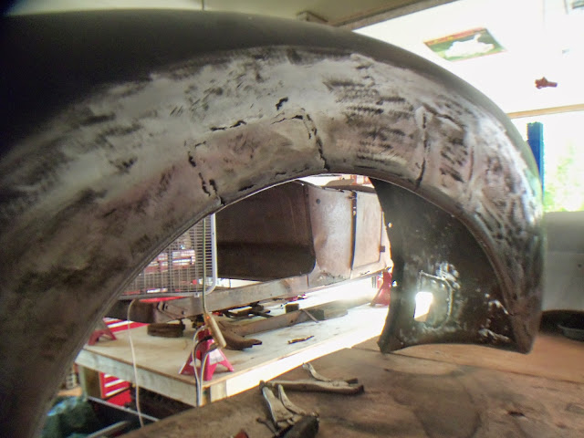

This week I'm getting the 40 Ford finished up for final prep and paint. The left front fender has been a bit of dilemma - here are my choices:
The black one was in fairly rough shape, with several patches having been welded in and a couple cracks having been welded up - which wouldn't have been the worse thing had the welding been done with any tact. Instead, the welds were huge, thick and solid, causing massive shrinking of the metal around them:
Looks pretty bad right? I thought so too - so I asked the owner to send out another fender he had....which I immediately sent to the sandblaster, uncovering it's own serious issues -
It get's worse...much worse :wtf:

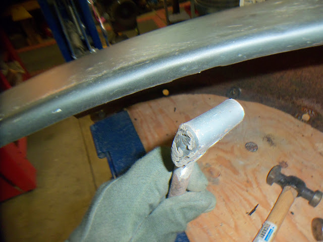

Somebody used metal rod to strengthen and shape the edges on this fender, which can be OK - if it's done with any semblance of skill....
Between that mess - and a couple major splits in the metal:
So I had to choose the least damaged of the two ****** fenders.... :willy_nil
SURVEY SAYS! :dunno:

Definitely NOT factory! These rods are often used to repair, shape and strengthen edges of large fenders and sections such as this, but - as I said - usually with much more skill and care than these examples show! The right fender has a rod in it that was done well, but this fender was done so poorly it's unuse-able - hence my choice to stick with the fender I already had, which has no rod, decent edges but several large, heavily-welded patches.
Upon looking at the huge repair on the fender in the thread you posted, I feel MUCH better about the amount of repair on the fender I have! ;)

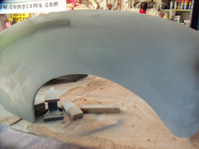

Oh well, after another 6 hours, I got one nearly done....just have to block out the primer a couple times.
Remember the giant patches and welds?
