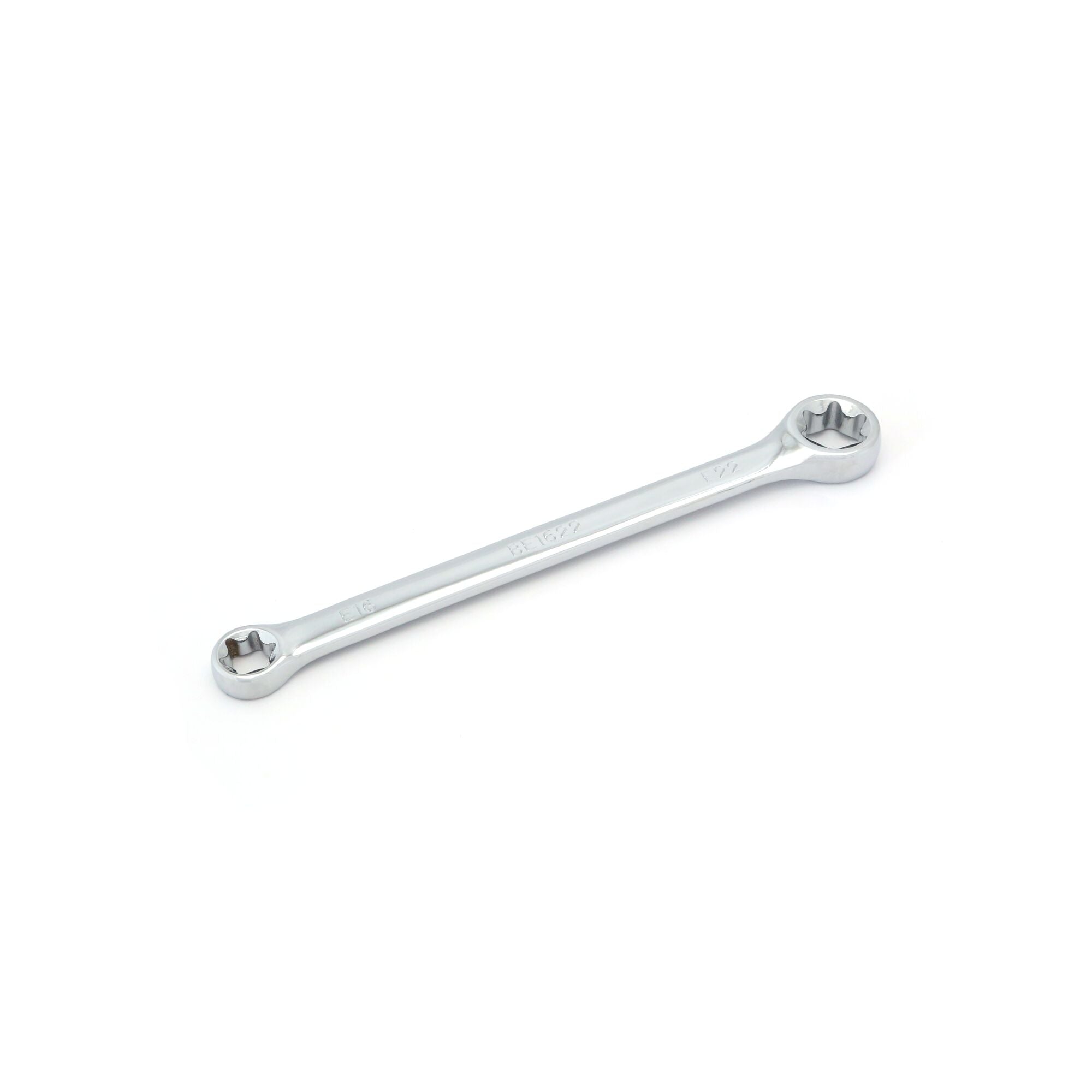

I bought this vim set after running into a few places it was difficult to get a socket, if I remember correctly it was a chevy 1.4 thermostat housing. I've had good luck with vim tools. I dont know if it includes 16 but from the pic it looks like it. Not sure if you can get them over there or not.
Vim Tools WTC624 Torx Box Wrench Set - 5 Piece https://www.amazon.com/dp/B000FN6PGA/?tag=atomicindus08-20
N
nezzman
Sep 18, 2021
103
Ahh, just what I am looking for. They are available here. I might just pick them up.
It includes the E16.

Also, while the quality differences between standard open box wrenches can be notable, and closed box ends less so - I would say that for etorx wrenches the quality gets very blurred. Poor tolerances won't really make much of a difference. I'd get a cheap set, I doubt the Snap On is measureably better (unless someone comes up with a valid reason?).
Toptul is probably a great choice (cause the quality isn't bad in any case). The AAAE1622 is their E16xE22 size. I'd get all of their wrenches and they probably cover most of the usual sizes. Then just supplement the extras if you ever really need them...
