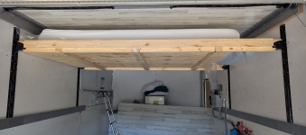

I converted the cargo trailer to an "toy hauler" - I use e-track for a bed frame. I can raise the bed up to the ceiling.
There are a few posts floating in the internet showing the bedframe style or work bench type usage. Quite ingenious!

@Model A Fan apologies as it slipped the old mans mind to get this done. Here are the images, apologies the delay!
