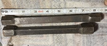

In my opinion, they're just very early fixed socket wrenches, probably made by a blacksmith. Similar to Gruber, or later, to Braunsdorf-Mueller and Vlchek, but even less commercial, and straight instead of an offset on one end. The square shank was for turning them. I don't think they have anything to do with the production of detachable socket wrenches or ratchets or other handles. I don't think you'll find a manufacturer, and I don't think there's a manufacturer to be found.

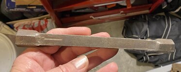

I’ve run across some doubles enders in my travels although I don’t know where they are now. I left this one behind at today’s estate sale.IMG_2051.jpeg

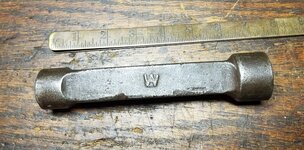

I found another doubled-ended fixed socket wrench this morning, hand-forged, square stock, similar to the three I already have and posted (post #2), this one marked. FAIRMOUNT.

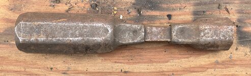

Adding this one, found at the flea this morning, to the topic. The hex service openings are 1-1/8" x 7/8". Something tells me that when I am dead and gone and my grandsons are going through all my cool old stuff, AJ is going to get this one without an argument. :)
