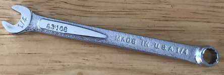

Here is what I have been able to come up with so far:
Combo SAE 12pt Wrenches:
63-108 1/4"
63-110 5/16"
63-112 3/8"
63-114 7/16"
63-116 1/2"
63-118 9/16"
63-120 5/8"
63-122 11/16"
63-124 3/4"
63-126 13/16"
63-128 7/8"
63-130 15/16"
63-132 1"
63-134 1-1/16"
63-136 1-1/8"
63-138
63-140 1-1/4"
63-144 1-3/8"
63-146 1-1/2"
63-152 1-5/8"
63-154 1-11/16"
63-156 1-3/4"
63-158 1-11/16"
63-160 1-7/8"
63-162
63-164 2"
Combo Metric 12pt Wrenches
63-608 8mm
63-609 9mm
63-610 10mm
63-611 11mm
63-612 12mm
63-613 13mm
63-614 14mm
63-615 15mm
63-616 16mm
63-617 17mm
63-618 18mm
63-619 19mm
63-620 20mm
63-621 21mm
63-622 22mm
63-623 23mm
63-624 24mm
63-625 25mm
63-626 26mm
63-627 27mm
63-628 28mm
63-629 29mm
63-630 30mm
(not sure if this exists) 31mm
63-632 32mm
Double Box End 12pt SAE Wrenches
62-110 1/4"x5/16"
62-112 5/16"x3/8"
62-114 3/8"x7/16"
62-116 7/16"x1/2"
62-118 1/2" x 9/16"
62-120 9/16"x5/8"
62-124 5/8"x3/4"
62-126 11/16"x13/16"
62-128 3/4"x7/8"
Double Box End 12pt Deep Offset SAE Wrenches
62-616 7/16"x1/2"
62-622 5/8"x11/16"
62-628 3/4"x7/8"
Double Box End SAE 12pt Deep Offset Stubby Wrenches
62-814 3/8"x7/16"
62-816 7/16"x1/2"
62-818 1/2"x9/16"
Double Box End SAE 12pt Stubby Wrenches
62-314 3/8"x7/16"
62-318 1/2" x 9/16"
62-322 11/16"x5/8"
Double Open End SAE 12pt Wrenches
61-110 1/4"x5/16"
61-112 5/16"x3/8"
61-114 3/8"x7/16"
61-116 7/16"x1/2"
61-118 1/2" x 9/16"
61-120 9/16"x5/8"
61-122
61-124 5/8"x3/4"
61-126 11/16"x13/16"
61-128 3/4"x7/8"
61-130
61-132 15/16"x1"
61-136 1-1/16"x1-1/8"
Double Open End Metric 12pt Wrenches
61-609 7mm x 9mm
61-614 12mm x 14mm
61-615 13mm x 15mm
Any additions, corrections, etc. is much appreciated. Thanks!

Updated Easco Wrench Lists:
63-607 7mm
63-608 8mm
63-609 9mm
63-610 10mm
63-611 11mm
63-612 12mm
63-613 13mm
63-614 14mm
63-615 15mm
63-616 16mm
63-617 17mm
63-618 18mm
63-619 19mm
63-620 20mm
63-621 21mm
63-622 22mm
63-623 23mm
63-624 24mm
63-625 25mm
63-626 26mm
63-627 27mm
63-628 28mm
63-629 29mm
63-630 30mm
63-632 32mm
Combo Metric 6pt Wrenches
63-906 6mm
63-907 8mm
63-909 9mm
Combo Metric 12pt Wrenches - Midget
66-408 4.5 x 4mm
66-409 4 x 4.5mm
66-411 5 x 5.5mm
66-412 5 x 6mm
66-413 5.5 x 6mm
66-414 6 x 7mm
66-416 7 x 8mm
66-418 8 x 9mm
66-420 9 x 10mm
66-422 10 x 11mm
Combo Metric 12pt Wrenches - Full Polish
63-707 7mm
63-708 8mm
63-709 9mm
63-710 10mm
63-711 11mm
63-712 12mm
63-713 13mm
63-714 14mm
63-715 15mm
63-716 16mm
63-717 17mm
63-718 18mm
63-719 19mm
63-720 20mm
63-721 21mm
61-608 6mm x 8mm
61-609 7mm x 9mm
61-611 10mm x 11mm
61-614 12mm x 14mm
61-615 13mm x 15mm
61-619 17mm x 19mm
63-108 1/4"
63-110 5/16"
63-112 3/8"
63-114 7/16"
63-116 1/2"
63-118 9/16"
63-120 5/8"
63-122 11/16"
63-124 3/4"
63-126 13/16"
63-128 7/8"
63-130 15/16"
63-132 1"
63-134 1-1/16"
63-136 1-1/8"
63-140 1-1/4"
63-142 1-1/5/16"
63-144 1-3/8"
63-146 1-7/16"
63-148 1-1/2"
63-152 1-5/8"
63-154 1-11/16"
63-156 1-3/4"
63-158 1-13/16"
63-160 1-7/8"
63-164 2"
Combo SAE 6pt Wrenches
63-810 5/16"
63-812 3/8"
63-814 7/16"
63-816 1/2"
63-818 9/16"
63-820 5/8"
63-822 11/16"
63-824 3/4"
Combo SAE 12pt Wrenches - Midget
66-010 5/32" x 3/16"
66-012 3/16" x 5/32"
66-014 13/64" x 7/32"
