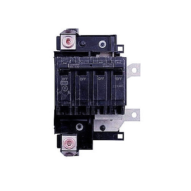

brewchief
Sep 20, 2008
2,372
It may be possible to add a main breaker to your inside panel and then use a basic interlock, some panels are considered convertible and have the option of adding a main breaker.

ANy reason you can't have two main shutoffs? seems like an easy cheap route!
That's how i'd like to go i know reworking the outside stuff like whyliesdiesel says is ideal just....i have 2 kids heading to college soon so $$, and with everything running off LP , a few k just to run some lights and outlets seems overkill which is why i haven't done this yet, During ian we lived comfortably for days but i had drop cords everywhere. And by now i've worked around my lack of subpanels in some areas (garage, pool shed) i have 220v in another building...reworking all that isn't really critical.
But if i can add a main like above that's the way to go for my needs too. add main interlock, outside is 20 feet away easy drop, boom done get on to more enjoyable ****.
I'd have already tossed in a generac homelink (switched neutrals vs reliance) if not for having the main in drywall and that adding some time, but i'll investigate above again tonight, that had totally slipped my mind.

in fact...funny i just remembered that review first review on that amazon link was
Bought this 200 amp main breaker conversion kit, but not through Amazon. It fit my GE indoor 200 amp lug panel breaker box perfectly, and let me install a generator interlock kit. Great. Ended up purchasing through local big box store (online and shipped to my house for free) for less than $100. Wanted to buy through Amazon, but not when it's being sold for over 3x the price. Shame.
i'll check this again a bit later when have time not sure how to tell yet if the panel is convertible outside of it does have a main breaker knock out so i'd assume so

confusing a bit load center IS TM4020CCU MOD 6 and front is tm40bcd
all that decodes to main breaker which there is none except knock out ?
says all main lug convertable to main breaker.
Course this panel is from 03 or 04...but i think that verbage would imply reverse if main lug is convertible to main breaker, the inverse would be true? (my job relies on technical docs i tend to think alot between lines due to the missing bits in verbage).

Could use a double check but it looks like these powermarks the main breaker is convertable and visa versa so i just need
and
i already have a free 240 double pole 30 amp breaker as thats unused (LP dryer) so that leave an inlet box and 8 or 10 gauge it's short 10 gauge would work (< 30 feet max up wall over 15 feed down outside wall).
then boom in business

yeah that's the confusing thing ...
if you have a different load center model number for main lug, main breaker, and convertible (tlm)
is that just sales verbage for out it comes out of the box but they're all the same? as i have a main breaker model number obviously without a main breaker implying they're all same just depends on how they're sent out the door.
The ABB breaker docs mention convertible
PowerMark Gold and PRO main circuit breaker kit for use in 150A, 200A, & 225A convertible load centers - Example - TLMXX20CCU - 200A Convertible Load Center - Includes mounting base - Not for use in 125A and below Convertible Load Centers (TLMXX12CCU) - Main Breaker Conversions for 125A load centers - see footnotes for individual catalog numbers
whcih ok i get but then why do i have a main breaker part number without a main breaker if they're not all just removable or addable.
i think all TM means is main breaker factory installed , but then why the tlm verbage on the breaker conversion shrug..

sheesh i think i found it, tried to find install for the thqmv200e (formally 200d) conversion kit..
NOTE: This main breaker kit fits all 100-225 ampere TLM/TM load centers labeled “MOD 6”. This breaker kit may be used on TLM or TM load centers labeled MOD 1- MOD 5 but the Front must be replaced with a MOD 6 compatible Front. For a list of replacement Fronts, see the Front package carton or visit www.GEindustrial.com.
my panel is TM4020CCU MOD 6
So TM & TLM are interchangable. Lordy....mind screwing model numbering...

that was the one, plug and play install, torqued to specs, lucked out with an easy fish thru drywall and insulation into the panel. Glad brewcheif reminded me of that here, i had looked at that a year or two ago and thought 'not sure how to tell compatibility i'll revisit it' and forgot....had to have reminder and moment of sanity from a thousand things to dig thru the doc.
