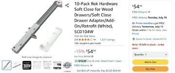

I know that to some degree, I’m looking for a unicorn here. I understand that part of how soft close drawer works is that opening the drawer pulls the spring and ***** the mechanism that later catches and closes the drawer.
Over the winter, I installed the retrofit soft closer mechanisms like these on most of my kitchen drawers
They work fine, but ever since I’ve been getting complaints from SWMBO about how hard the drawers are to open now and how she doesn’t like them. They do have a harder pull, which bothers me less than the bang/crash of her hip-closing the drawers, but pointing that out is Not Helpful (tm).
I’m about to make some new drawers for the cabinets in the hallway, and they need new slides. So, I’m looking for some new slides that are soft close, but that don’t have (as much) of the hard pull penalty. Google says that there are some slides advertising an easier pull, like these
but they don’t really define or quantify “effortless”.
Any real world experience with a particular set of slides? Are there any that are likely to work better than what I have now?
I’m making three drawers, so the price isn’t all that important for this project. If she likes them, though, I’ll probably need enough to re-do the kitchen, which could get expensive.

I have the KV slides in my kitchen, I think that exact model. Edit: yep, 8450 in 22"
Very smooth in/out when properly adjusted. In general soft close require square boxes and tighter width tolerances then standard slides, so keep that in mind.

The side mount soft close slides are not great, I used those kv soft close once and though the same thing (excessive force needed to open)
If you step up to the world of undermount slides, that extra opening force requirement is less noticeable.
They are also cheaper
Since I’m making the drawers, I can go side, or undermount, it’s all the same to me at this stage.
What makes the undermount better? I always assumed that it was essentially the same mechanism, just rotated 90*.

Unless you are using Blum sliders, you are going to have one problem or another. We had some cabinets installed by a company that refused to offer Blum and we ended up having to trash what they sent us and retrofit for Blum. (Life has been fine and effortless ever since.)
BTW - Your pulls will also make a difference on how you feel the effort to open the drawers.
