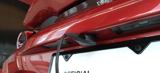

Rosenberger MagCode connectors are almost exactly like the MacBook Magsafe connectors you're looking for, @chicken12.
They're not easy to find in the US, and the eBay sellers in @Firebrick43's initial highlight of this type are at prices about 2X those inside Europe -- but at least they'd be available. Note that there are two parts to a MagCode connector -- one needs both ends, of course, not just the one shown on eBay -- and addition to modifying the vehicle with its end one needs to modify the charger to add that end, too.
The non-locking kind noted by Firebrick43 are exactly the right kind. The magnets grab into place like your MacBook and they'll pull off just as easily if one forgets to detach it.
Ferrari use that connector type on their private-labelled CTEK chargers. Here are some pix a few weeks ago at my local dealer.
