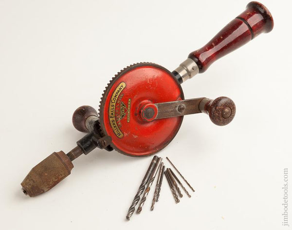

Here are a couple of mine. First a Millers Falls 2A, with a countersink bit mounted. This was taken in 2003, so a very early acquisition. Chef's hat side knob hidden from view
And a newer acquisition Millers Falls 980, looks alot like the 2A, but not. No bit storage in the handle, made post 1925.
And for those trying to make a replacement side handle, looks like a 5/16-20 thread.

OK, instead of jumping into the Stanley family, lets stay with Millers Falls for another post or two.
Here is a Millers Falls 2B, hard to estimate age other than post 1938. This one only displays Made in USA on the handle

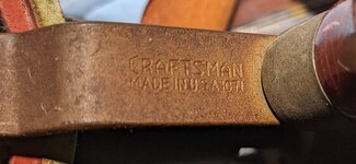

The third member of this set is the oddball, the black sheep of the family, and gives a good view into Sears Craftsman outsourcing The marking on the handle is Craftsman / Made in U.S.A. 107.1 And if we remember our OEM list, that is Millers Falls. This plane appears identical to the drill above, (except it has a chuck). Only came with one bit, storage in the handle, but it is not marked.
I will have to verify this one is a Sears catalog, see if the time frame matches the drill above. It might actually be a No. 2, need to track the subtle differences, another time.
RTM … are you sure about that craftsman? Here are pictures of one i just got, everything except the number is different.
I was saying my Craftsman drill was similar to the Millers Falls I posted right above it.
Your 107.1 is 99.99xxxx% Millers Falls in my mind. Gimme a few to poke around oldtoolheaven. I am guessing yours is later, based on the closed wheel without spokes. That tapered body should be easy to find. Edit:I should clarify. The HANDLE with the 107.1 is Millers Falls. Not sure about the rest, it is possible they changed the handle
As you saw at oldtoolheaven, there were lots of Millers Falls drills, and a smaller % of those may have been sold as Craftsman.
One that jumped to mind was the #38, not definitive at old tool heaven, but this image is much better and similar.
So poking through and looking at the non-definitive ones may help by googling more images
I think they did. Even though it fits perfectly, the silver screw holding the crank handle in place is apparently not original: it’s tight as a tick but not touching the handle, so it’s too long.
That outer rim under the handle got me thinking about that.
Somewhere I have a drill where the wrong gear wheel was installed. Looks great but the teeth pitch is just a bit off, and it binds after 1/3 of a revolution or so.

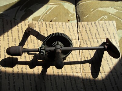

I am trying to identify a breast drill. I have spent over an hour scouring the interwebs to no avail. Any help would be appreciated. Made in the USA A213 in one spot and A214 in another with what looks like a brand mark, but not sure. What do you think experts?
If its not an early version of the Stanley 723 (different chuck, without the level?), I'm guessing a low budget brand. Not gonna be Millers Falls, etc, but rather an off price entry late in life like 1950s. The lack of style, the lack of a finger guard around the gears, as seen even on the simplest MF is missing (as seen here on the 0477)
That PC mark might be the foundry that cast it.
I did find its brother

I’m agreeing with RTM for a couple of reasons. The teeth look to be cast, not cut. There is no idler gear. They borrowed a gear wheel from a different design: it has a smaller row of teeth for a second speed, but no way to move the crank.
I looks like the quality of tool that a company would keep in the tool trailer for workers who didn’t have their own. Or maybe for high school shop class.
