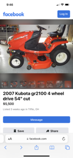

Next I tried to look around and see if there were any used mower options in decent shape (minimum 20 years newer) - preferably with 4 wheel steer (lots of trees to mow around).
So here was another option at about half of retail... 15 years old and half of retail. My wife didn't go for it. "If you're spending that much go new".
