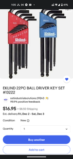

Don't know about warranty, but I just got an sae metric set for about $20 after combined shipping thanks to some jackass snaking the last set out of my truck.
