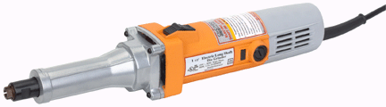

I am looking to buy an electric die grinder. I think I have settled on a Milwaukee, but I'm not sure which one to get. They have two basic models, a 4.5 amp that is approximately 13" long, and an 11 amp that is about 21.5" long. I was leaning toward the 11 amp, but it sounds like a monster to handle.
Anyone own either model? If you have the 4.5 amp, does it have enough power to run cutoff wheels? If you have the 11 amp, how does it handle, awkward or no?

I had a need for one a few years back, a friend wanted me to put some patch panels in his blazer and it wasnt running, he also didn't have an air compressor. So I thought well for $30 I could buy the one from Harbor Freight :shocking:and use it to get the job done then it will probably die :lol_hitti or spend mega $$$ and get a brand name.
Well it's been a couple of years now and it's still going strong, they had them on sale a few months back so I purchased another one and have one with a stone mounted on it and a cut-off wheel on the other one.
They have been real handy on my welding-gringing bench. It's only rated at 4.3 amps but it has never stalled on anything I have tried to cut.
I have taht one... no problems with it so far...
