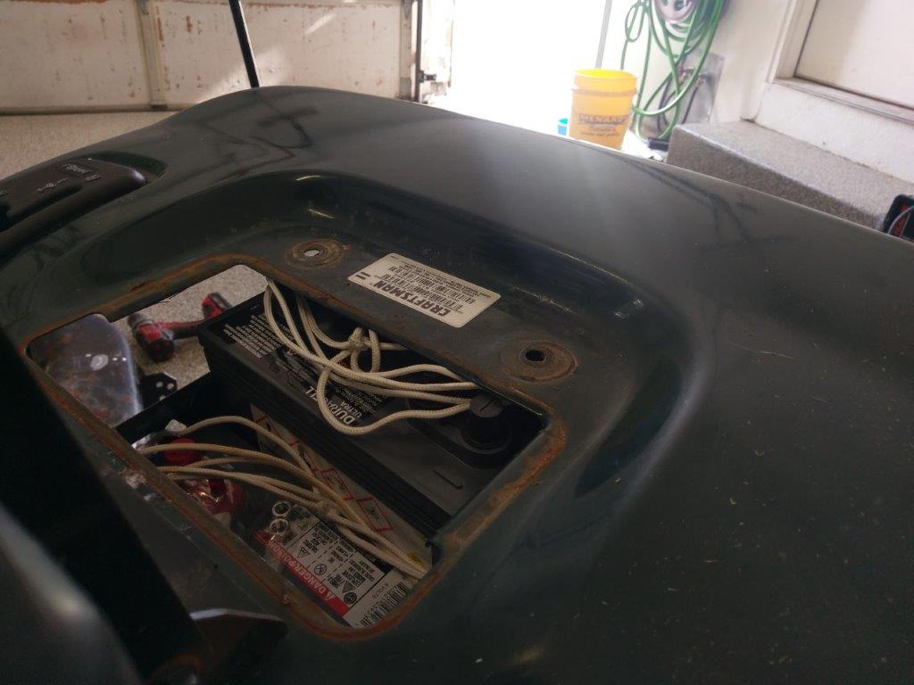

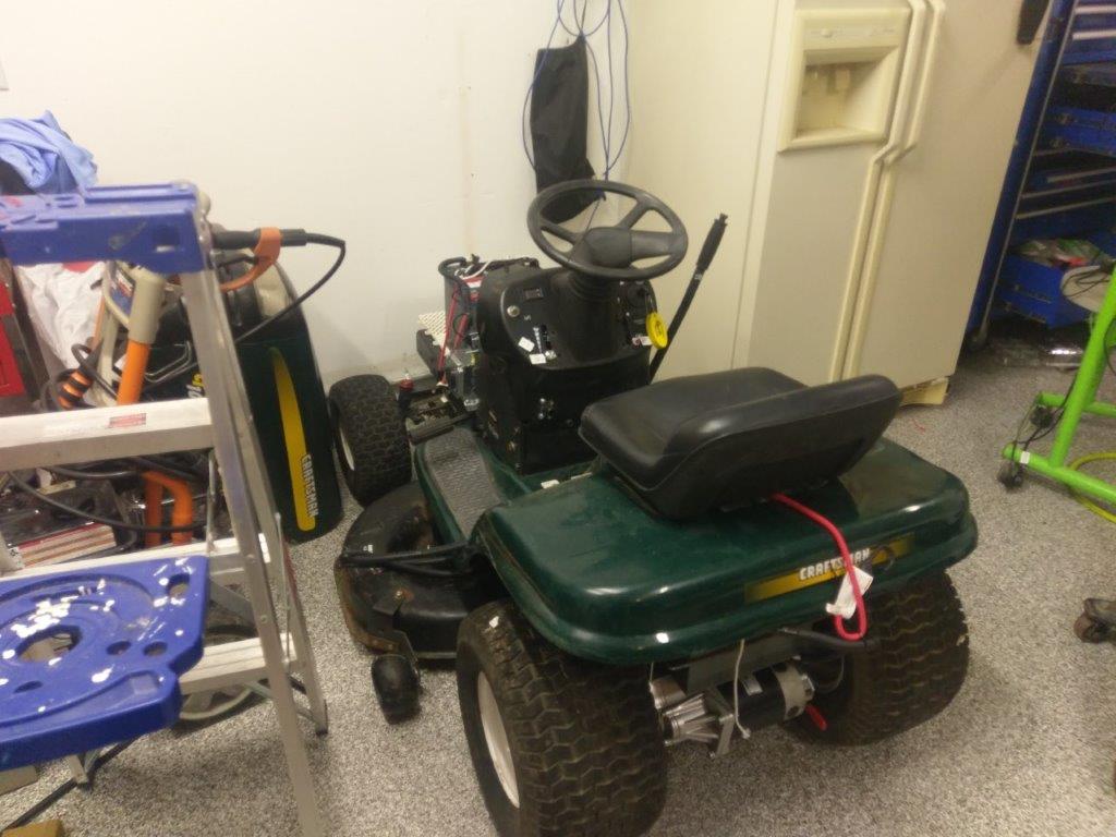

$50 bucks donor Mower : Craftsman Riding Mower 42 Inch cut

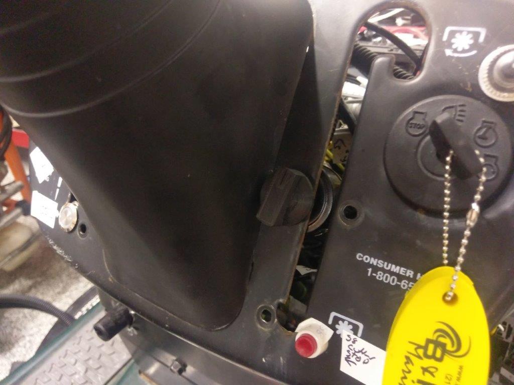

Tear Down
IMAG0

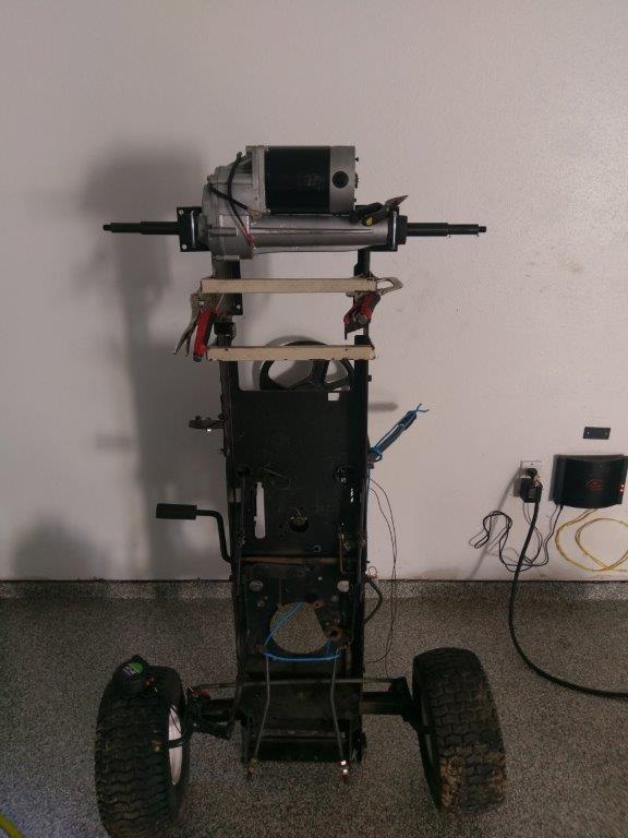

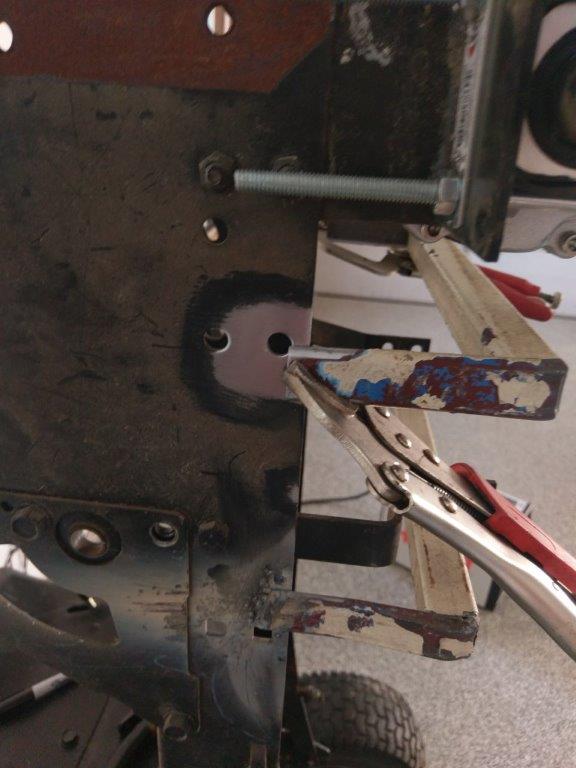

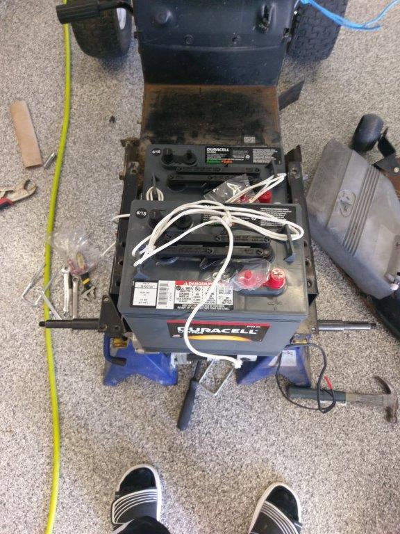

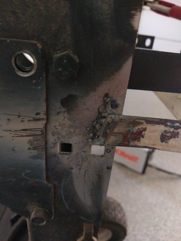

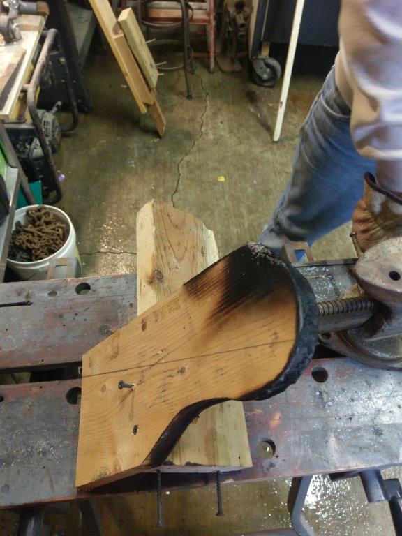

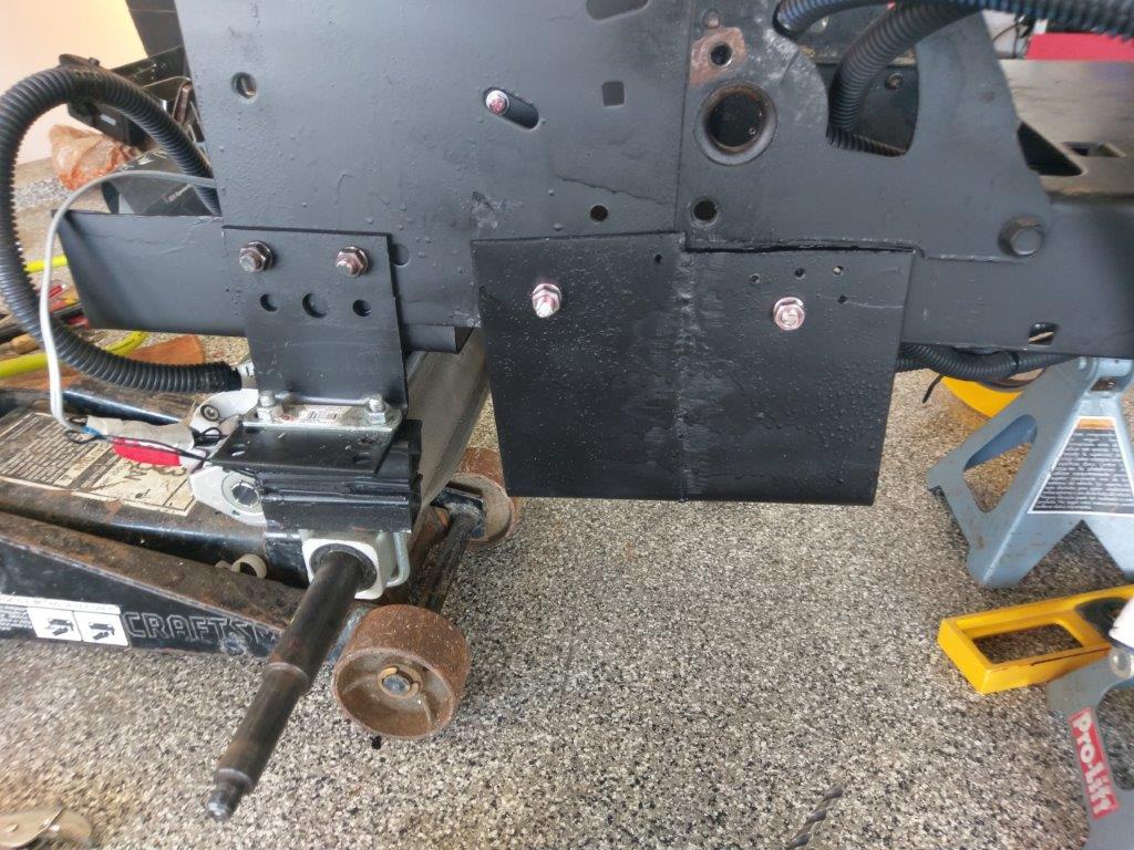

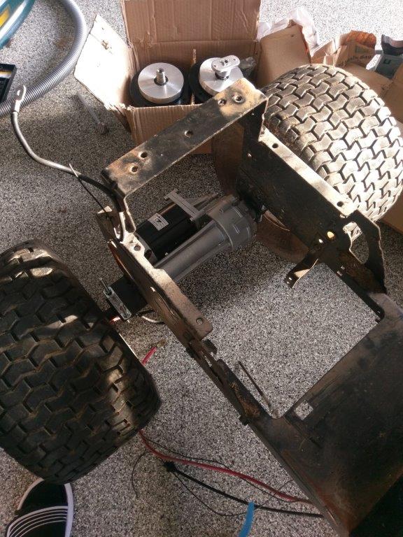

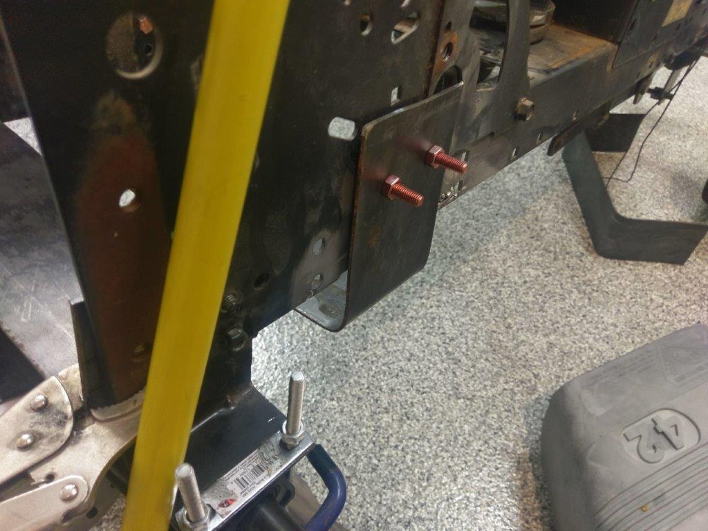

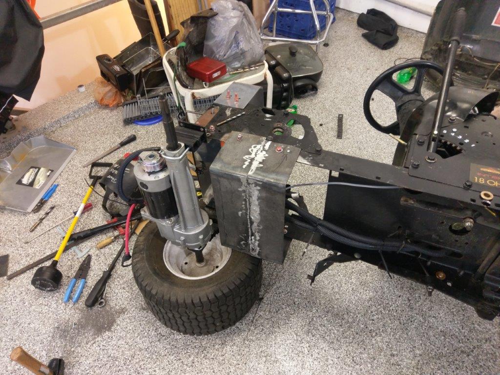

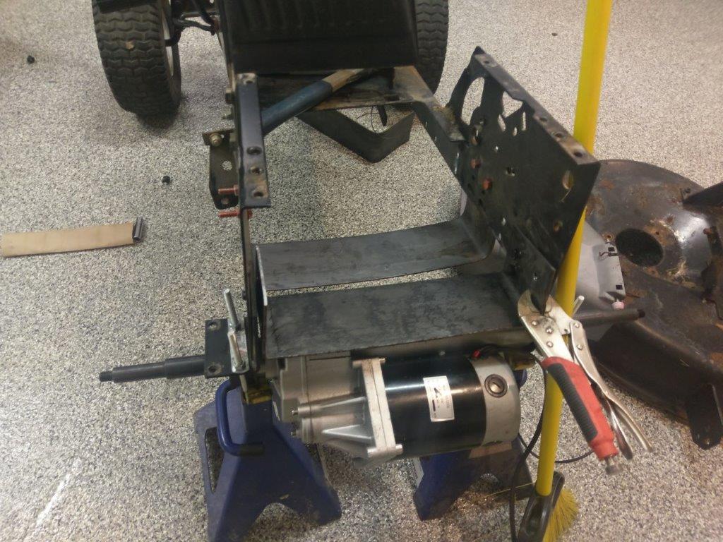

Now time to mount the electric transaxle, this drives the unit forward. Also working on the battery tray. First attempt was a major failure as I cannot weld to save my life. After that occured I just bolted some flat steel plate and then with the help of my neighbor powder coated it chrome.
Failure :(

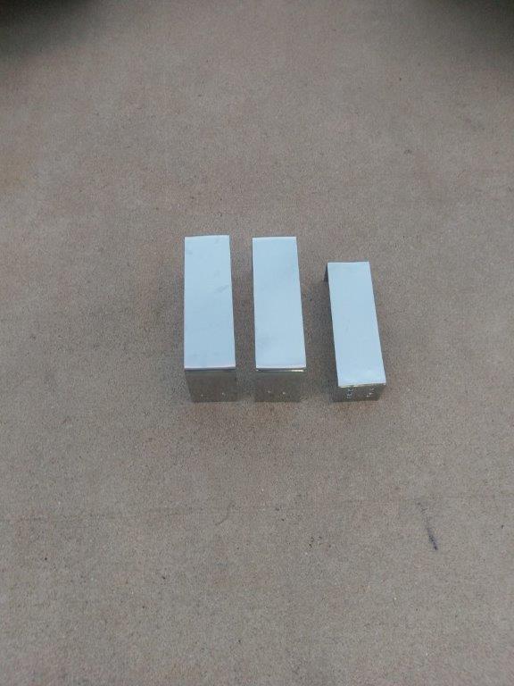

New idea!! Use bolts , give up the welding idea

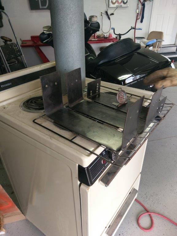

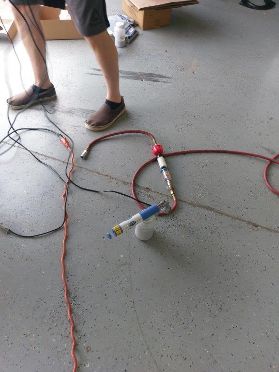

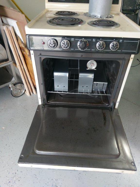

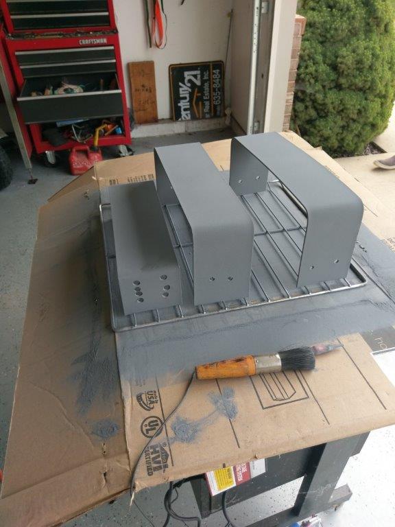

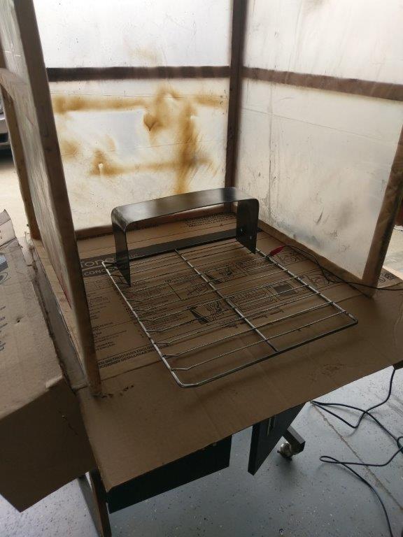

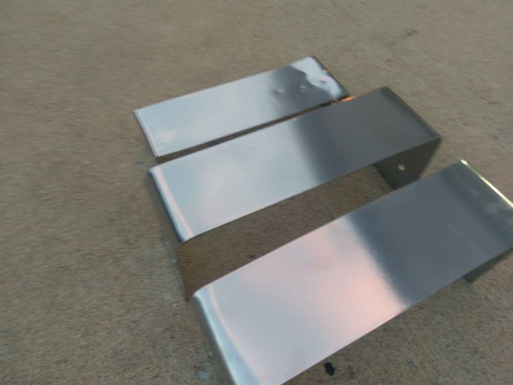

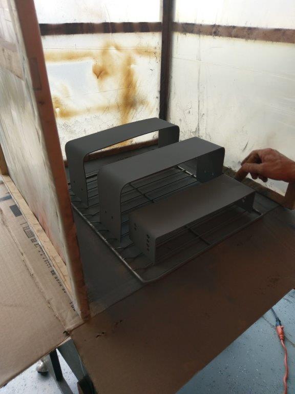

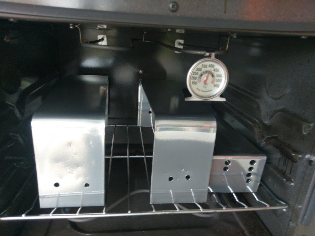

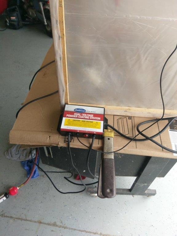

Power coating, this was pretty awesome to do had no idea you could do chrome.

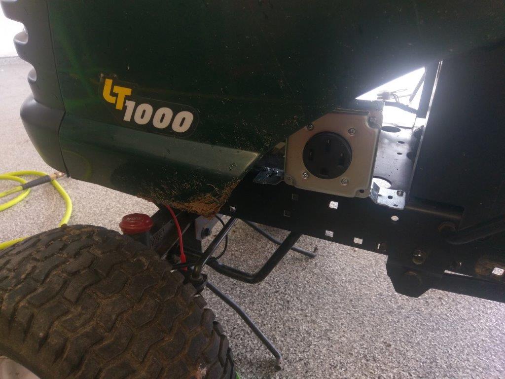

Electric PTO where the cutting deck plugs in.

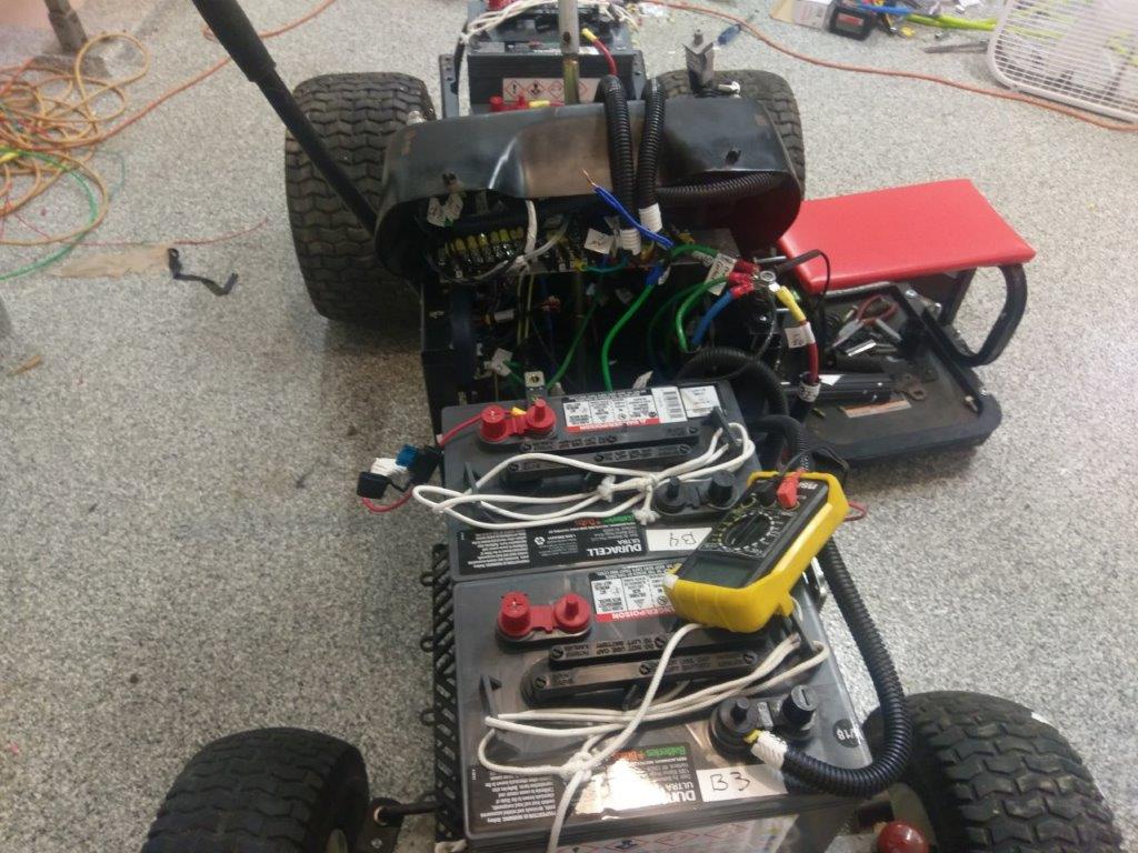

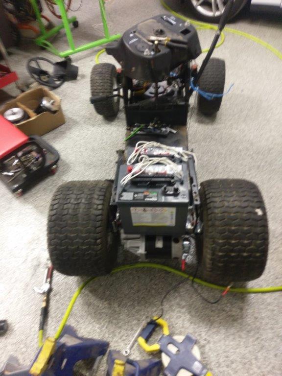

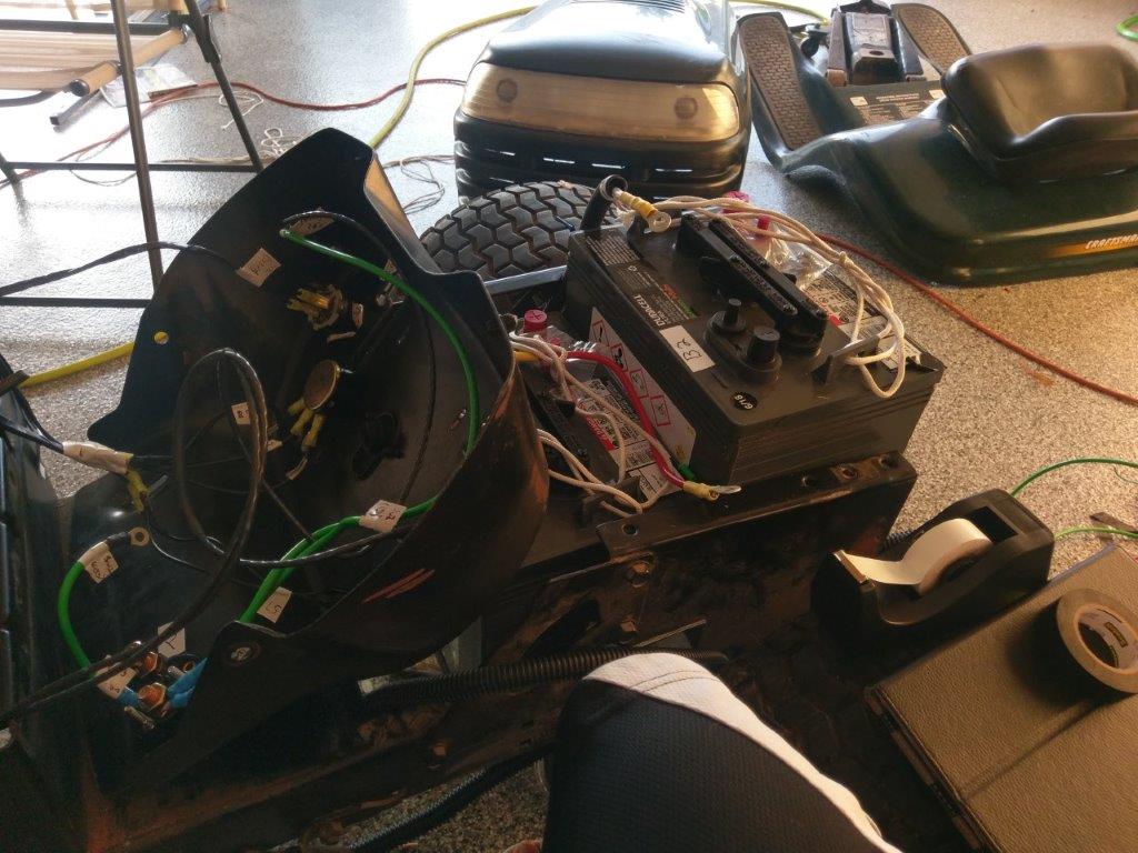

Wiring from the kit, overall pretty straight forward however time consuming

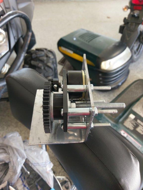

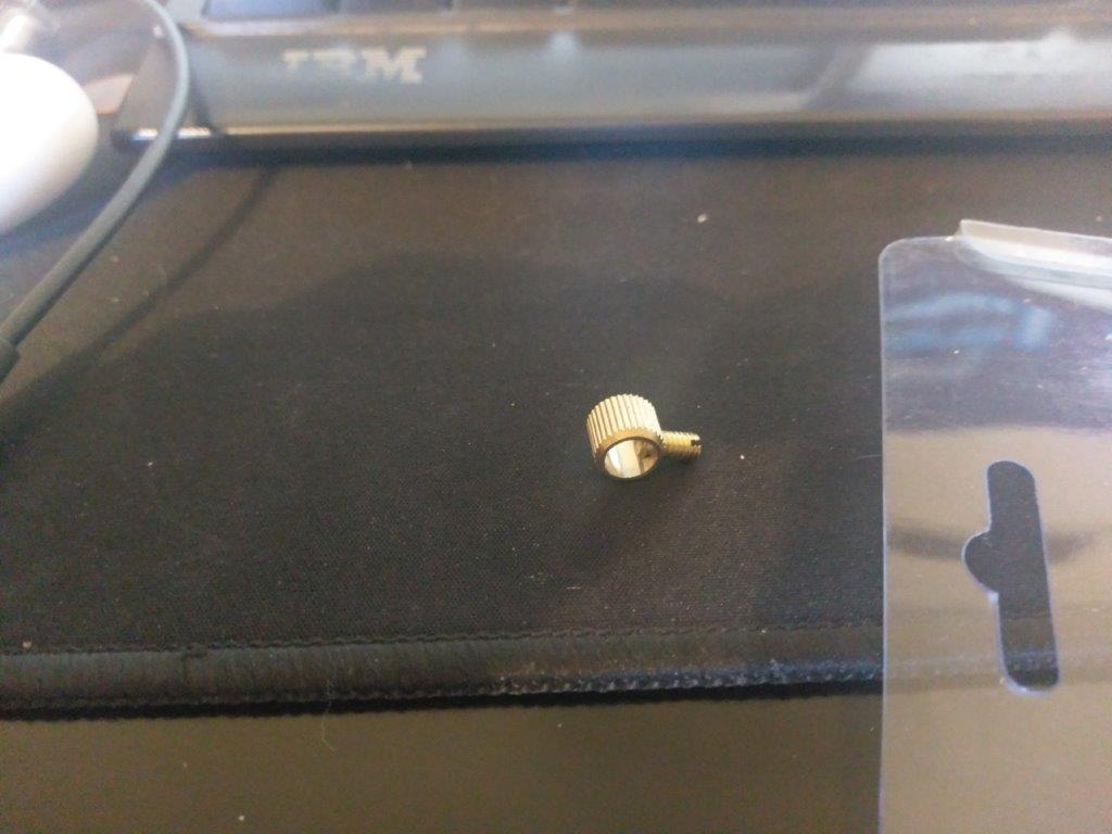

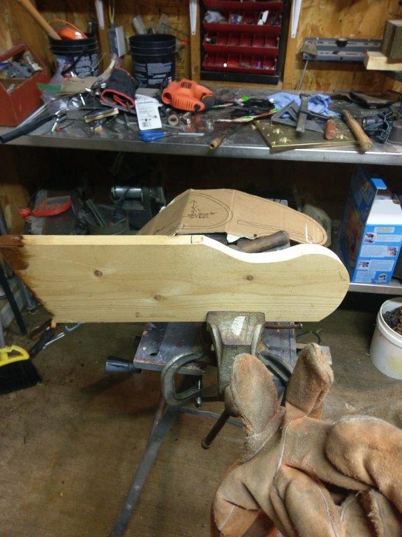

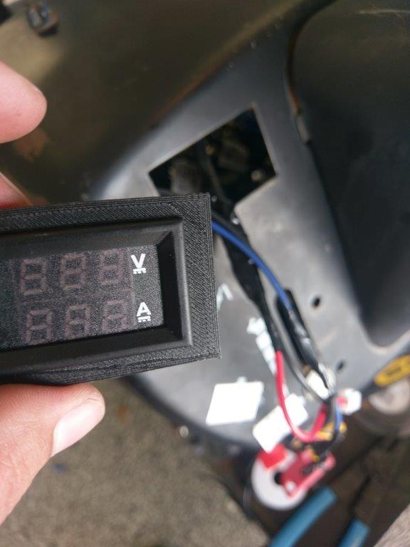

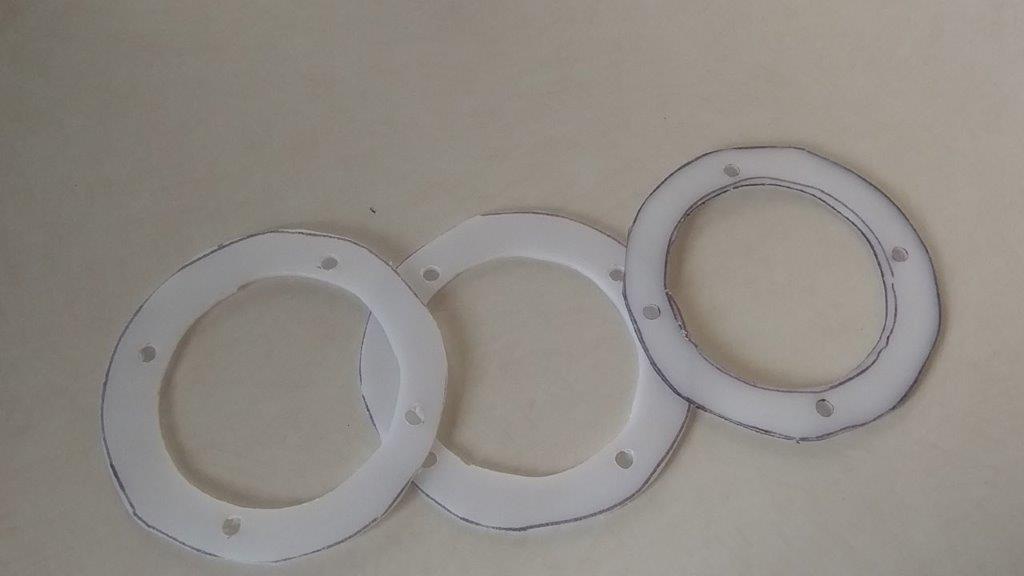

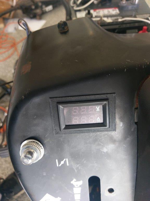

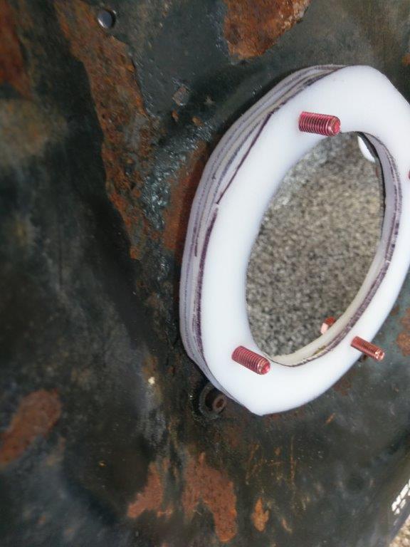

I needed to 3d print a couple parts, first was a shim for the Voltage / Amp Guage. Went into tinkercad and mocked it up and fit perfectly. Also printed a knob for the temp speed control.

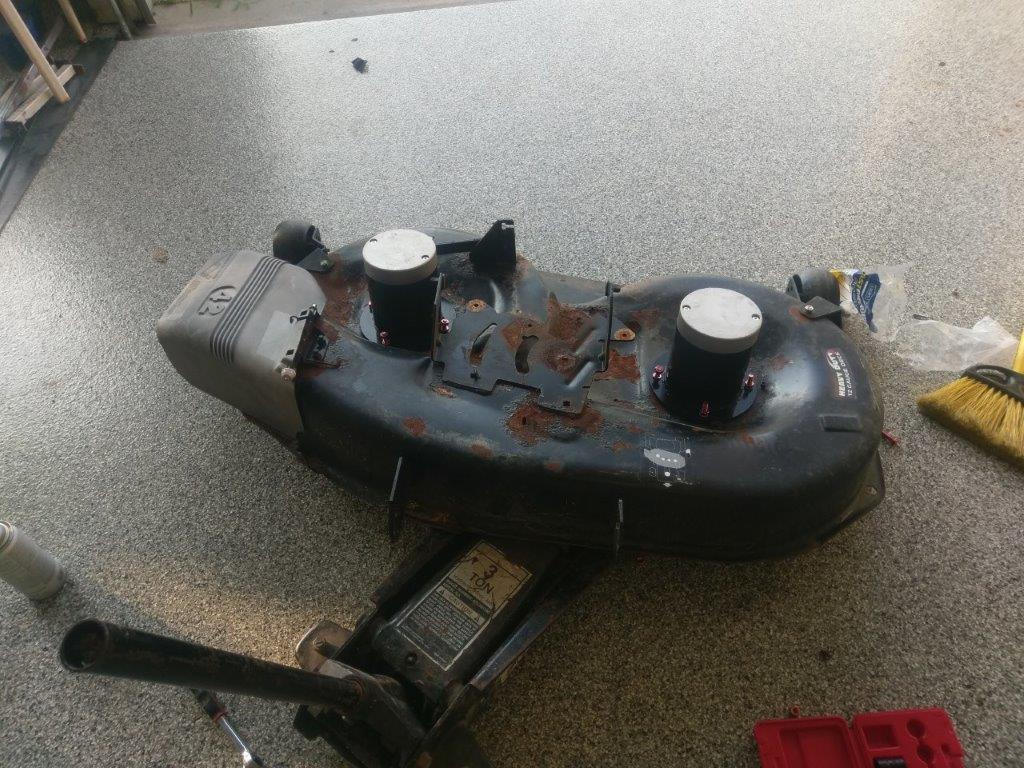

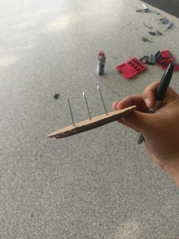

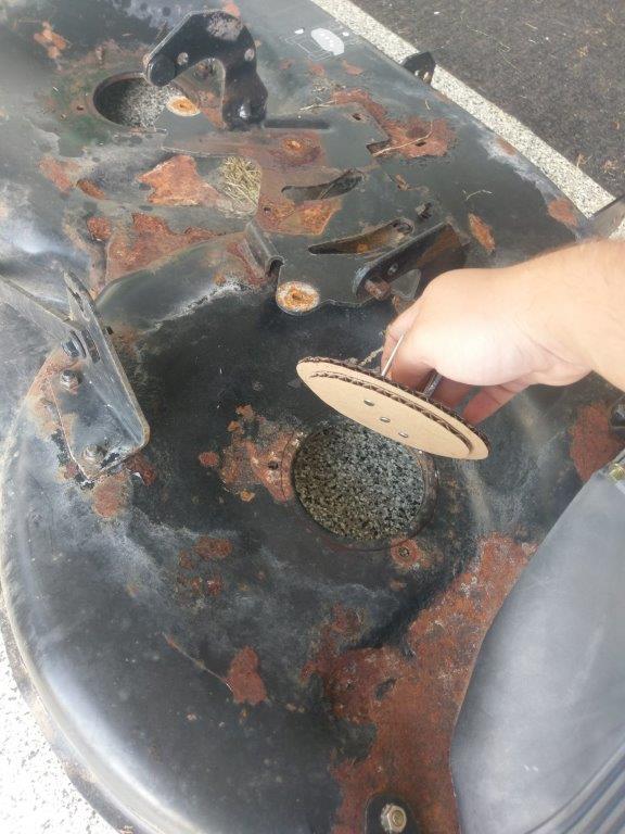

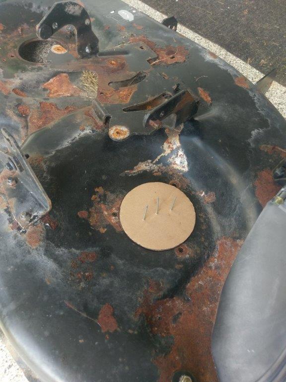

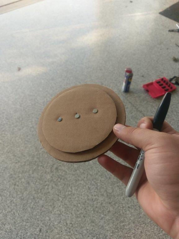

Cutting Deck, the holes in the deck were to small to fit the motors so I created a template from cardboard and marked the deck which needed to be removed. Cut that out and then fit the motors, which were too low so I used cutting board material to make shims. Overall seems to work ok, I plan to have a local fabricator create a metal shim for me this was just a mock up.

Those lead acid batteries are NOT going to have a long life ! "Engine starting" batteries are design to give very short, high current power, not sustained power for any period of time. You would be better off with TWO 6V golf cart batteries.

They are 4 6V golf cart batteries....

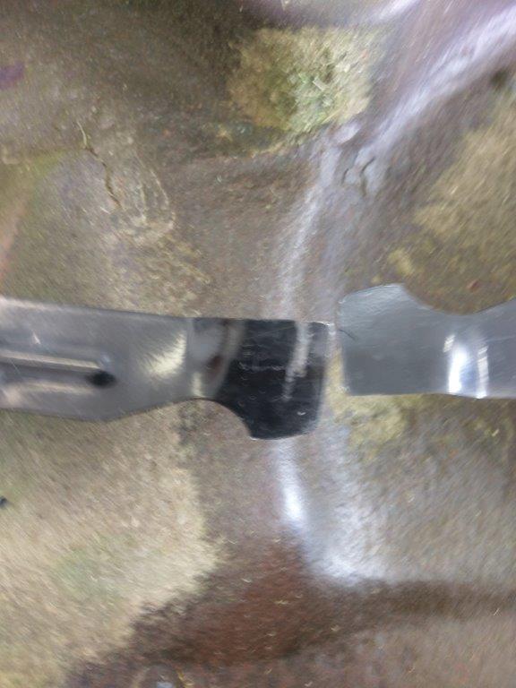

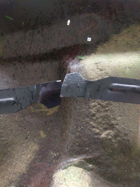

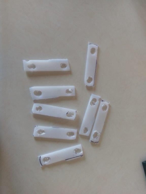

For a bit of an update.. I was having issues tripping the breaker for the right cutter motor and noticed it was getting really hot while mowing. After talking to the company that sold the kit we determined that the blades I was using were to heavy. (Almost 1.5lbs each). Since I was having so many issues with the motor I decided to take the motor apart and noticed some of the windings were slightly burned, figuring this was not good I ordered a new motor. Personally, I think I just happened to get a junk motor since the other one was fine. Not wanting to run into any issues moving forward I ordered new much lighter blades from a Cub Cadet RZT S ZERO which were less than 1/2 the weight of the original blades. With the new blades it mows like a champ, sort of..
I put the new blades on fired it up and BAM! Both blades hit each other. At this point I was so pissed words cannot describe. When I ordered blades on eBay they listed them as 21”, however they really are like 21.183" which was enough to cause them to interfere with each other. To fix this problem I removed some material from each end of the blade and balanced them. Now its working without any problems.
Fixed:

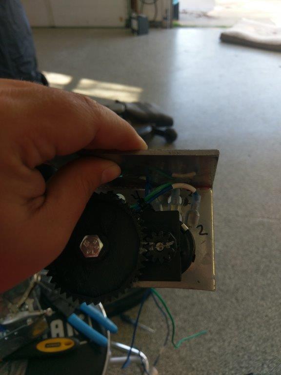

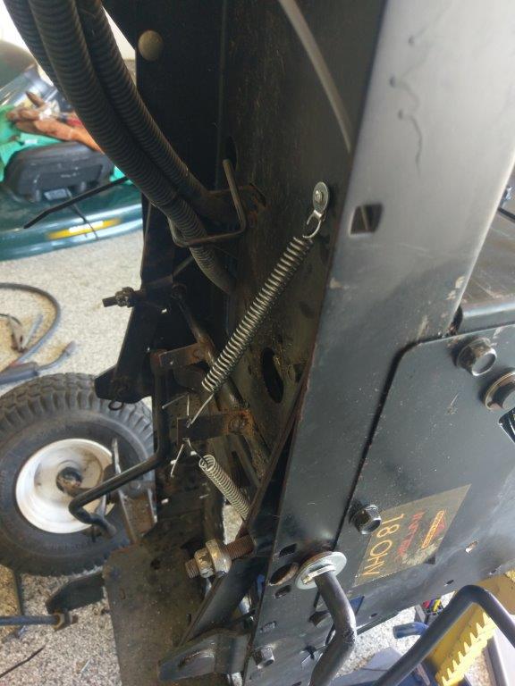

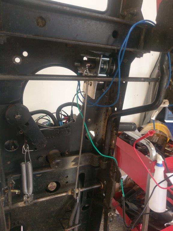

The throttle was initially configured to just work by turning a knob on the dash. Overall this proved to be a pia, and not great when switching between forward and reverse, working around trees and hills that pop up when mowing. So I created a foot pedal by bending a piece of metal rod and shaping it with a wood template. Not really working with metal like this before was interesting. The foot pedal has a arm that is connected with a piece of metal attached to a gear box. I 3d printed the gears and messed with all sort of ratios starting at 4:1 (way to sensitive) and working down to 2.75:1. This really could probably work with 2.5:1 however for now it’s working so I will leave it as it is for a bit. The gears are connected to the potentiometer with a knurled set screw thing I was able to break out of a potentiometer knob. If anyone knows what this is officially called I would love to know.
Two springs work to center the pedal. This is working out well and was much better than one spring as I had it in the initial design.
This shows how the arm connects the setup is a little different this was the first attempt. I dont have a good pic for how it is now.

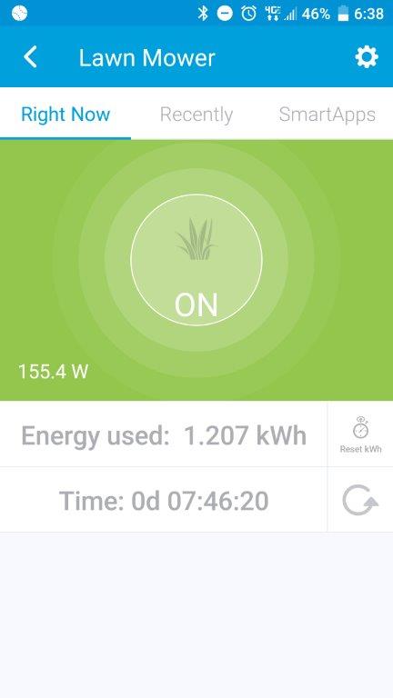

After mowing with three times now my average cost per charge is right at $0.12 for just under an acre. The charge time is just under 8 hours with my 5amp charger. This could go faster however higher-powered chargers got expensive very fast.
Pic from the smart plug for the charager.

Nice project - You're welding has definitely improved :)
Do you grow you own (electricity)?
Still not great for sure, but had a boilermaker buddy show me some things which helped alot. Also the shade I was using before was way to dark so I couldn't see anything. As for electricity I am planning to install solar this summer which I'll probably do myself. The grass icon signifies lawn mower :)

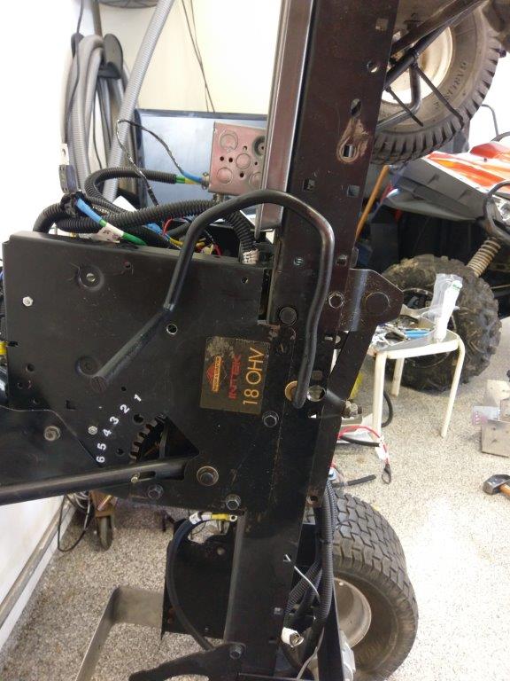

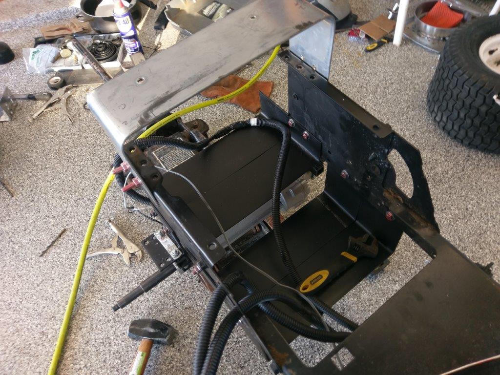

First I gutted the Crafsman, and took out the wiring harness. Which was a complete mess it was not designed to be taken out after the install.

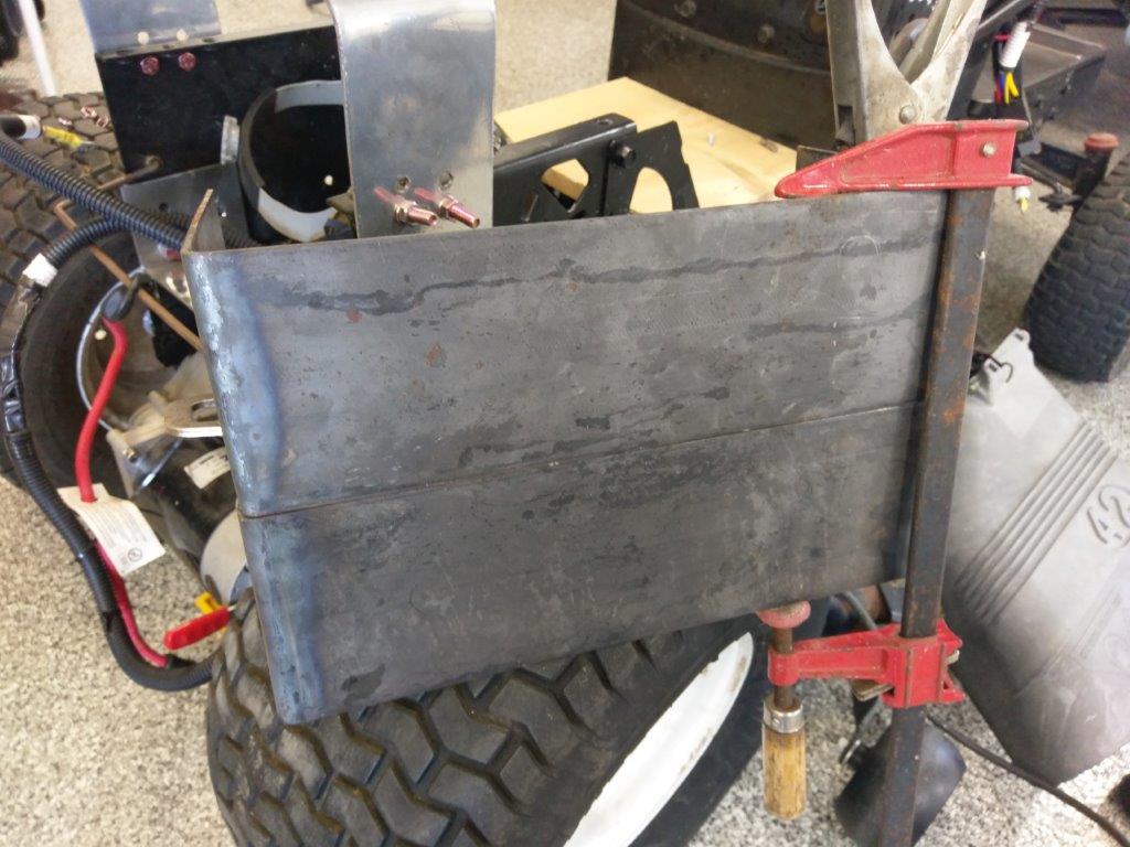

For the batteries to fit I had to weld in a new battery box in the rear of the tractor and remove the deck raise lever as it was in the way.

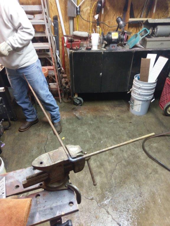

Additionally instead of cutting down the rims of the JohnDeere I needed to extend the axles. I bought some 3/4 round stock, and had a machine shop bore it out to 27/64's. I then tapped 12 x 1.25 threads and screwed it to the transaxle.
All the wiring was rebuilt using automotive style water tight connectors. Additionally I wrapped and grouped cables in loom which looks was nicer.

Instead of trying to fit the John Deere deck with motors (it used 3 spindles and i only had two motors). I used the craftsman deck. To get this to work I had to weld a front bracket onto the mower for the front to attach. I then had to weld two brackets on the back to help keep the deck center. (also helps keep the deck form moving backwards when the front it connected) . For the raising and lowering of the deck I used steel rope.
I had to do this since I removed the original bar system that was on the tractor as it interfered with the batteries. Honestly this system works out really well, I am pretty happy with how it turned out.
You can see the bars I had to weld on the back of the frame. They connect to the flat stock that is attached to the frame.
