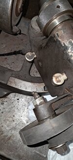

I canciled the one I bought and purchased a black&decker which works fine but I am missing the stone dresser and the part used to grind the valve stem flat. There is no model on it it just says a645 and I will send pictures maybe someone can tell me more about it to get parts.
