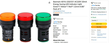

I do like the 240 Volt industrial pilot lights I put them on my well pump and air compressor.
https://www.amazon.com/Baomain-AD16-22D-AC220V-Energy-Indicator/dp/B00G9JQ0UA/?tag=atomicindus08-20

micromind
Sep 24, 2023
3,101
Fernley, Nevada, about 30 miles east of Reno.
I doubt you are saving much if any energy with this game.
The fact that the tank takes 3 days to cool off indicates it is well insulated and has very small stand by losses.
Heating the tank up from cold requires a huge amount of energy. Turning it off would make sense for a month or more but overnight is silly.
Those will fit in a standard 1/2" knockout hole (7/8").
