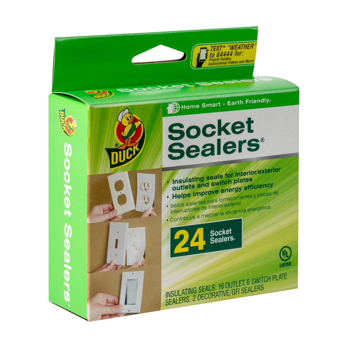

Socket sealers!

^^This is the best way. Those foam sealer things are basically worthless if the boxes aren't sealed anyway. I don't have foam behind my drywall, but I seal all the box penetrations with foam, then either a thin bead of foam or caulk around the box depending on how well the drywall was cut. No cold drafts at all.
