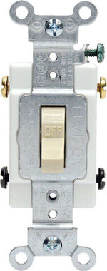

I have a 5.0 hp 220 V motor that has only two wires in the cord.
To make a 220 V supply do I connect to the 2 lugs on a 220 V breaker?
I can use the breaker for switching; how bad is that? (note: this will be only 'til I can get to town to buy a switch)
Here is a typical 220 V switch pic. Do the 2 wires from the motor go on one side (i.e. left) and the wires from the breaker go on the other side?

This isn't electrical guru territory. This is electrical basics.
240v in north America is two hots, on from each buss in the panel. A 5 hp motor should not have a cord
It may be prudent to hire an electrician and see what is done. There is more to this than figuring out where to plug a couple wires in

hp-rated switch
When I clicked on the link it took me only to the Amazon home page (I tried it twice). When I searched for "hp-rated switch" on Amazon all sorts of stuff came up that I couldn't relate to. What should I put in the Amazon search box?
Thanx so far; how 'bout the breaker box question?

So googling "220V hp rated switch" it came up with switches all the way from 14 bux at HD to a Hubbel at $155.
I am still unsuccessful searching Amazon.
What am I really looking for? i.e., specs on or description of the switch.
Weird. The product in the link is a Leviton MS303-DS
As for the breaker, use a 2-pole breaker. Typically the black wire on one terminal, and red wire on the other.
Thanx. Searching Amazon for Leviton MS303-DS gave me results.
The breaker answer is what I expected but wanted confirmation from someone more experienced/smarter than me.

b-t-w; fwiw; this thing will never have much of a load on it. It's the only "extra" motor I had laying around. I'm building a rotating tumbler to clean rusty bolts and such. I doubt it will ever have as much of a load as a drill press or lathe.
It will be the inrush and not the running load that welds the switch contacts. You don't just need a HP rated switch, you need a 5 HP rated switch.

Ayuh,.... That switch says 120v, right on it,.......
Regardless the load, that motor wire a 2 conductor cord is not properly wired for 220v operation,....
Well; sorry about the pic. It's just one that came up when I googled 220 V switch. Your (probably much younger) eyes caught the writing. I can't even read it.
As for the properly wired message it's apparently the original wiring on the motor. I can't guarantee that though. I'll get into the connection box on the motor and see what it looks like. There usually is a diagram on the inside of the cover.

Some bad part numbers above ! You want a motor rated, 2 pole, single phase switch, like a Leviton MS302-DS. It is rated for 5hp on a 240V circuit.
Actually it says 120-277v on my monitor. Never have I seen a 2 pole single throw 120v only switch.
Agreed on a 2 conductor cord being improper for a lot of reasons. Plug connected 5hp, no ground etc.
Often at supply houses the 2pole isn't stocked, and the 3-pole can be substituted with one set of terminal positions going unused. That's been acceptable to my AHJ in the past.
Got an example of a 3 pole switch that you are referencing?

As long as it's not a disconnect, a single pole switch can be used for a 240V application, I never do it but it is code compliant, but the OP is failing reading comprehension 101, the motor is a 230V motor not 220V.
