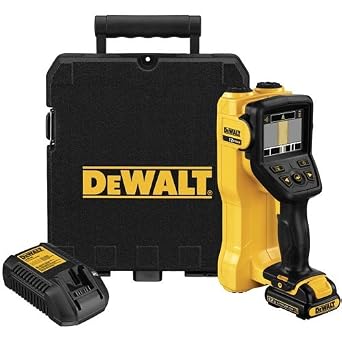

Buy this... find your wire... then return it for a refund. Amazon is great about returns. :D
http://www.amazon.com/dp/B00ACF6QTC/?tag=atomicindus08-20
Damn, now that would be the cat's *** right there. :thumbup: I don't think I'll buy one and return it though because sure a ****, as soon as I decided to do that, Karma would kick my **** somehow and I'd end up owning it. :lol:
