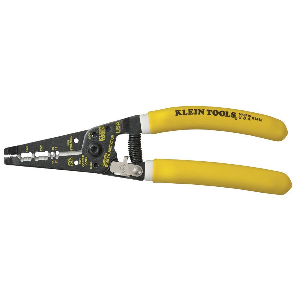

How do you like them for Romex?
Don't use those for Romex. That'd be a pain in the ***. Get a Klein Kurve or the Southwire equivalent.
https://www.amazon.com/dp/B000F9HIEC/?tag=atomicindus08-20
https://www.lowes.com/pd/Southwire-Wire-Cutter-Stripper/50081544
I have both, and while I'm a Klein fan... I have to say the Southwire cutters are basically as good and they're stainless so they look a lot better. I have not used the screw cutters on the Southwires though, but I imagine they work the same.

I personally dislike the Klein tools stripper. Maybe I just need to grind or drill out the rivet for the locking "feature".
In reality is goes like this, strip once, open the lock, strip another wire, open the lock.
Unless I am stripping 18awg or 20awg, then you can just use continuously. No experience with the NM Cable version
Yeah, it's annoying that they haven't fixed this yet. I give the rivet a quick crush using the corner of my bench vise to tighten it up. Then it stays open until you close it.

Okay, I try to learn new things occasionally. It's been about 14 years since I worked extensively in electrical, so my tools might be out of date. I own one of the Klein strippers that everybody has been recommending and the OP was proposing to buy. Picked it up a couple of years ago at a yard sale, but didn't like it enough to really try it out.
I'm curently wiring a house; and the task right now is to wire in switches, lights and outlets. So, I've been making myself use the tool instead of the Klein needle nose pliers I usually use. I've used it for two days, long enough to see if it's an improvement over my previous habits.
The Klein tool works okay. Of course, it strips the wire easily and well. So do the needlenose. It bends the loops okay, using the holes. Okay, so does the needlenose. It cuts the wire okay, so does the needlenose. What it doesn't do well is assist in wrapping loops around the terminal screws and clinching them closed more. The grippers on the end work for that, but nowhere near as well as the needlenose. So, I found that I'm carrying a pair of needlenose also, and picking them up when the going gets tough.
So, I'm back to my original preference; utility knife, klein needlenose with stripping groove in the cutter, flat screwdriver for plates, and Snap-on ratcheting screwdriver with #2 phillips for terminal screws and mounting screws.

The strippers he linked to will loop wires and it's how every electrician loops wires. Have never seen an electrician use needle nose to loop a wire. Strip wire sheathing, strip individual wires, cover hole with finger and insert wire till hits finger and twist wrist. Done. No grabbing two tools to do a simple job.
Guess you haven't seen a lot of electricians - worked several industrial electrical jobs, some use needle nose, some don.t
I have those and like them but in my opinion they are not for romex wires. I use them on auto electrical.
Yes they will work just fine and sounds like you already know how to do it like a pro.

Thanks to this thread, I am now the proud owner of these, I just tried them out.. As someone said, one tool to do it all. Until now, I've been using a knife (carefully) to slice the sheath, then peel it back, cut it off, leaving a ragged end. Then the strippers for the black and white wires. When putting the fixture on, needle nose to loop the wire with needle nose. Then tighten the screws with a screwdriver. Now just this tool and the screwdriver.

I have a pair of those. I find that they nick the wire when I try to use them to cut insulation or strip wires. Maybe it's just the pair I have, but since I don't see how I could adjust them, I don't use them anymore.
