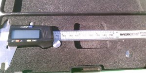

I've got one of the variety of cheap $20 digital calipers here (probably similar to whatever you get at HF) and it's great for taking quick measurements. When I've tested it against my good Mitutoyo (conventional) verniers I've always found it agrees to the nearest thou (0.02mm). The Mitu's are smoother and feel a lot nicer, but I've gotta admit I use the cheap digital ones much more often, just due to their convenience.
BTW. Mine works fine on those cheap alkaline batteries. I replace the battery about every two years, and at a cost of about 50 cents I've definitely got no complaints. :)
