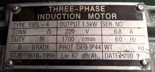

Does the motor have a spec plate on it? I question if it is really 2 HP as you wouldn't be able to run a real 2 HP motor on 110 volt, 20 amp outlet. Does the motor actually draw 6+ amps?

Thanks Firebrick. So for your money you would be looking at Teco and AC lenze?
Here is a photo of the motor plate, got to check it out today.
