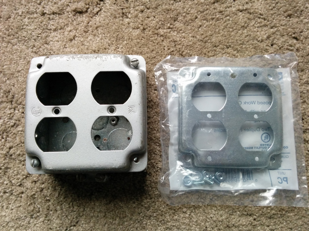

ALSO - Do not use "Industrial covers", but rather regular stainless metal flat plates on devices mounted to the mud ring.
WAY more durable.
See, w the "Industrial cover", a duplex receptacle is ONLY supported by the central cover screw.
The raised covers have not had a single screw to mount them in decades, at least 2 screws are included in the package to properly mount each duplex receptacle, a ring & plate on a surface mount box looks like it was cobbled together with junk.
Here's a visual aid to help OP see what's being discussed:
Old style exposed work cover on the left, new style on the right.
It was a needed change. Though the old style with a single middle screw was faster to install, I've seen outlets bent and broken from being mounted that way in hard use environments.
