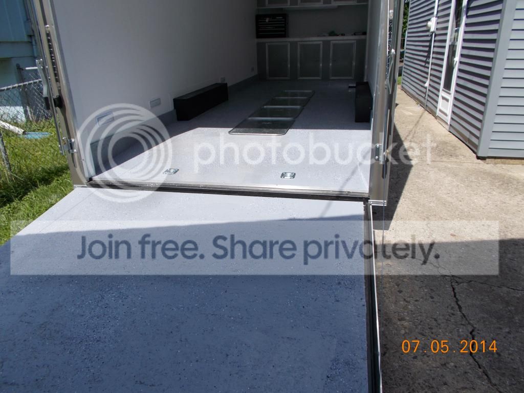

I had to get a tall one also. Then 24ft to accommodate every car we have. I added a tongue toolbox for the stabilizer bars, sway control and misc wood. Then an electric tongue jack, inside toolbox and removable winch. I've had both the vinyl and coin floors. Those were both too slick for me. The last two trailers I ordered with a bare floor and did the epoxy. The list can get endless with stuff to add. Just keep in mind what that stuff weighs. That half wall carpet looks really nice but I had to go vinyl white because I have some really old cars that sling oil like crazy. Mine also has drip trays down the center.
This is the day I picked up my current one. You can see the loading lights inside. Those are really handy. It also has ramp lights that are above out of the pic.

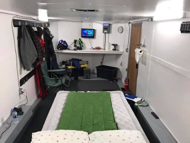

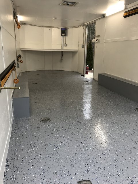

I've upgraded the lights in mine to LED. They are the grommet mounted back up lights found in most auto stores. Also added ramp lights front and rear. They are 6" LED light bars. I've replaced the yellow C channel on the ramps with Superglides. And an electric tongue jack.

moab11 : That's a very sharp looking interior! Did you Line-x the ramp also?
Thanks, I spent a lot of time planning this one out and applied a lot of the ideas I had from my old trailer. So far I am loving it, and have some ideas for the next trailer I build(hopefully not for a long time though).
The ramp is also Line-X'd, then I covered it in some ski guides to protect it better from snowmobile carbides and give some traction. Unfortunately I don't have any good pics showing that right now.

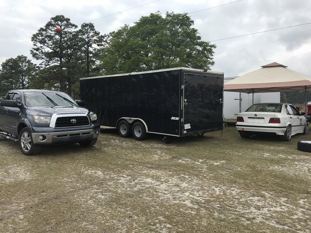

Mine's not a close to as nice as some others on here, but it serves the purpose, and goes along well with the low budget track rat theme of the track car. It gets used 4-5 weekends a year as a place to sleep at the track. Started as a used 20' Pace with the upgraded axles, think I paid about $3200 for it. Added: 30 Amp service, LED lights, outside 120V outlet and 30 Amp RV connector, Winch, insulation, epoxy floor, plywood on ceiling, small bench in the front E Track, small window etc. Not as nice as what you get if you want to spend $20k for a fully outfitted aluminum traler, but it works well for my needs. A couple of various in progress pics, bigger TV, missing the window, one doesn't show the roof top AC:

Here my 44ft Race trailer, that has a bed in the nose, shower and a sink.
The only modes I have made was installed lights under the tongue since it was dark, and some
Aircraft track instead of E-track as a tie down sys
Could see paying that much for it when I got this for a lot less
https://www.uscargocontrol.com/Airline-Track-12-Aluminum-Finish-Logistic-Track
Just install in sections.
We will be adding a fridge, cook top and I’ll be plumbing LP in the trailer. Absolutely love it and can’t wait to take it out.
Also need to find a toy to haul in it

What floor epoxy did you guys use and how slippery is it when wet? My current trailer has black/white vinyl floor and it's a skating rink. Picking up a new ATC 22 foot enclosed in a week, want something for the floor that you don't take your life in your hands when it's wet... Going to E-track the full length on the floor and a couple of pieces in the nose to hold the spare tires, tent, etc. Also looking at maybe doing ceiling cabinets in the front, shoreline and adding LED lights to the ceiling as well.
