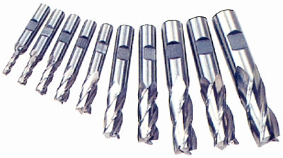

Not a professional, but I have sent plenty of time at a Bridgeport and small CNC machines for general prototype work so I feel like I can relate to your needs. If I were you, I'd buy a handful of 4 flute HSS endmills between 1/8" and 1/2" to start with. Your machine lacks the power and rigidity to take big 3/4" full depth passes out of things, so you know you'll be making multiple passes. You won't be running it hard enough to take advantage of any exotic coatings, and you're not using the machine to generate income so you can afford to run it a bit slower and easier.
MSC sells this Cleaveland set which would likely cover your needs, but If you plan on storing them in a drawer maybe buy them individually so you can get the plastic sleeves. For individual, Cleveland or MSC Generic "Made in USA" are more than adequate for you. Other than that, I'd say buy what you need when you need it. If you're hogging out a lot of material, roughing endmills are great.

I'd suggest you get HSS over carbide. Carbide is so hard it's brittle and will easily chip, shatter under excessive vibration or if there's excess play in the table, spindle, or a lack of mass in the machine itself. HSS can even be re-sharpened (to an extent) where carbide cannot without special grinding wheels. 1/8-1/2" will do just fine even if you're cutting slots. Don't bother with the coated cutters either, not worth the money and often use inferior steel under the coating. Don't buy a set, those are usually inferior cutters. Get individual name brand cutters like Putnam, Niagra, Guhring, Union, Greenfield, OSG, M A Ford, etc. Do a search for brands from an industrial supply NOT from the big box stores (cheap ****).

So I ended up ordering this basic kit
I think it should be good with my r8 collets and my mill.
I agree that my machine is not for 3/4" end mills due to its power and size but I do like the idea of having a kit that goes up to larger sizes for the simple reason of being able to machine plastic (nylon blocks). I make tool holders etc so they will be handy with the bigger sizes.
